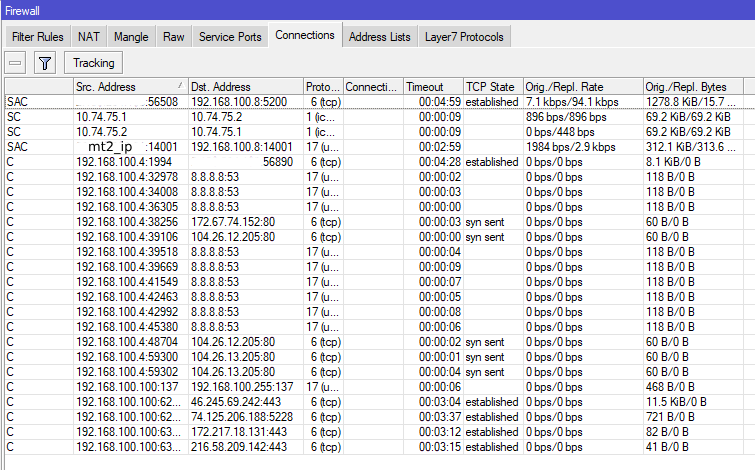

The attached picture is MT1’s firewall connections.
In my laptop I run curl api.ipify.org and I expect to show me MT2’s IP but I still see MT1’s IP..
