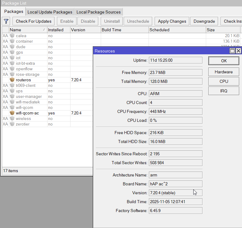

Yes indeed, except that the RBcAPGi-5acD2nD will not be able to use that driver, so it would have to be replaced by something newer. And on the hAP ac^2 that driver could in theory be used but the space on the flash will become very very tight and there may be issues when upgrading.

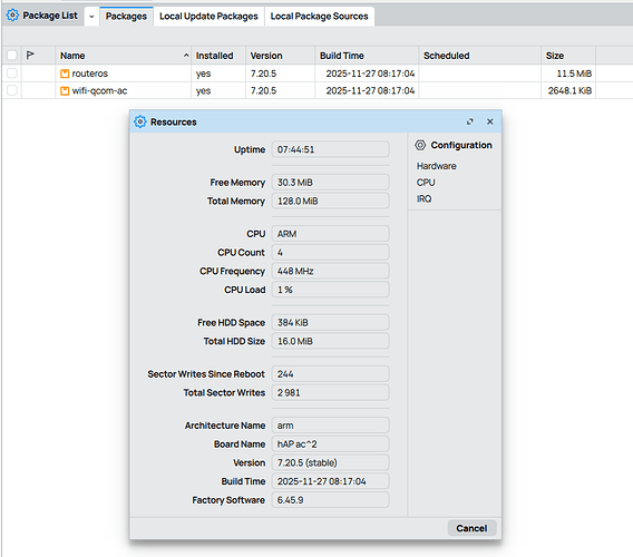

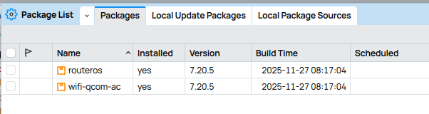

so I did a upgrade of AC2 to “new” CAPsMAN :
and it’s working all together
but I must check configuration under my hEX, because configurationCAPsMAN wasn’t assigned automaticaly.

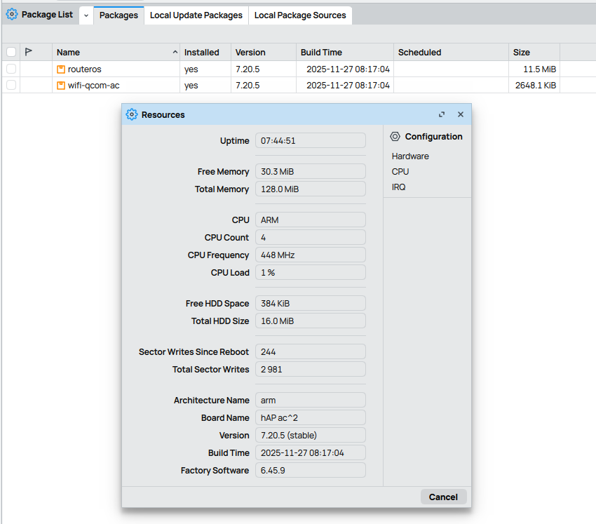

As far AC2, it works but as indicated, it can become tricky space-wise ...
(actually: pure platform wise there is no difference between AC2 / cap ac / wap ac / cap XL ac)
by me :
