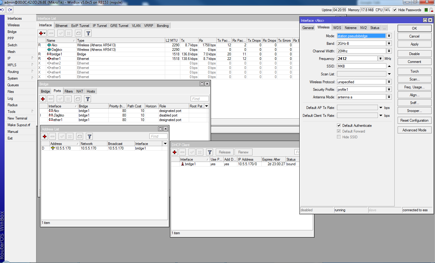

Than you for explanation. This is my configuration. I think my problem is related routing and ip adress.Because i dont do anything for routing also i dont know.
I think you should remove the gateway from the bridge. Then assign a different network to the bridge so that the wlan(your internet) and the local lan are on a different network. Check to see you get an internet connection when plugging into a port or over wireless (you need to setup DHCP or a static ip on your test computer). If the internet works then add the hotspot to the bridge.
jtroybailey is correct. Remove the gateway (WAN) interface from the bridge. Which interface is the WAN inteface?
The ip/subnet assigned to the bridge is not correct. It is a /32 subnet. I use /24, like this:
add address=10.0.0.1/24 interface=bridge1
I see you have “dhcp-client” on the bridge. Remove that. That should be “dhcp-server”. Don’t install the dhcp-server until the rest is set correctly.
Thank you so much, i will try your suggestion.
If you remove the WAN interface from the bridge, and it gets its ip by dhcp, you should set up the dhcp-client on the WAN interface only. Then set the dhcp-server on the bridge once the ip, route, and dns are set.
