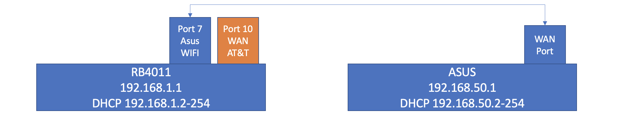

Let’s actually start from scratch. I have Rb4011 port 7 that is unused. Let’s use 7 for the wifi in router mode.

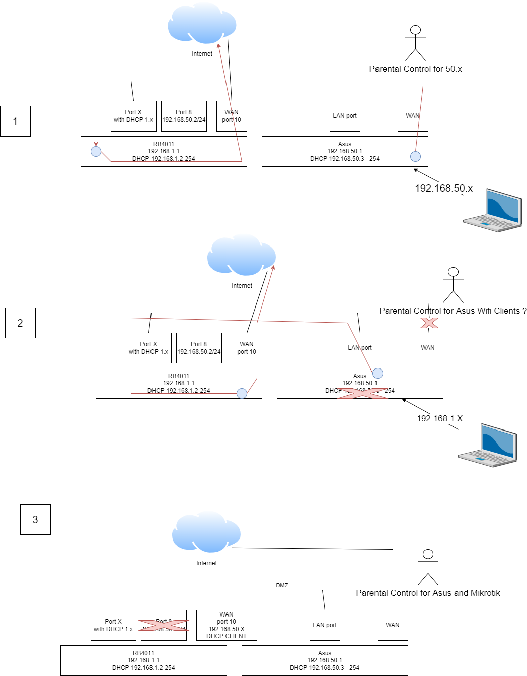

sorry, i messed up a bit. See these three scenarios.
Option 1 I assume you had at the beginning. Asus WAN plugged into mikrotik. There was no communication because by default ASUS did not accept incoming connections from the WAN. It gave parental control for its WiFi clients and 50.x networks
Option 2
You turn off DHCP on Asus, connect its LAN port to LAN with DHCP on mikrotik. In this variant ASUS clients should get address 1.x from mikrotik. I don’t know if parental control for them will work here.
Option 3
Asus as the main gateway to the Internet, mikrotik behind it. For VPN-type services to work, you should add mikrotik to Asus DMZ. Protection should cover both 50.x and 1.x networks
https://www.asus.com/support/FAQ/1011723/
I hope one of these scenarios meets your expectations.
The variant with port 8 should look like that you connect port 8 to ASUS LAN - then you can access ASUS from mikrotik network. Remember to route and change the dhcp scope on asus to free up the 50.2 address for mikrotik.
Let me know if it worked.
Regards :slight_smile:
Thank you very much for trying to work with out with me.
Option1 is what I need. Options 2 and 3 dont work for me. I have fiber, so the RB4011 needs to be in front to make the Dot1x handshake.
OK. So we have clarity.
You can set on unused port IP - dhcp client - port 7, Add Defoult Route Yes, Advanced , Default route change 1 to 5 and connect them to LAN Asus port. Now you should have access to them.
Or you can try it:
https://www.asus.com/support/FAQ/1000926/
