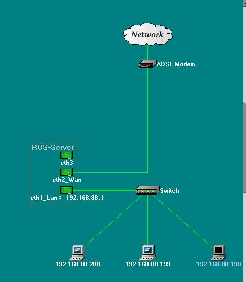

The following picture is my topology of network.
  1. When I copied a file form a station to another station, the traffic flow display in the diagram of “interface-ether1” and “interface-ether2” is nothing change ,the transport rate display in the “local connection” is up to 82Mb/s,is it means that the transportation is directly through the switch but not the Mikrotik router?

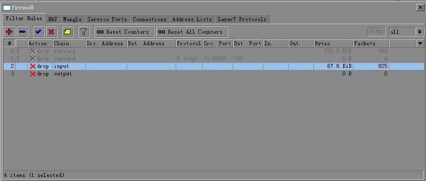

  2. After I used “drop-input” and “drop-output” command in the “firewall-filter rules”, I took for granted that it would sever the connection between each station in the ethernet. But it seems can’t work, I can use Microsoft workgroup to transport flies to and fro form each other.Why? and how can I do to isolate the communication of each station?

all communication between workstations should be blocked at switch. these packets go directly, not via the router

But as Chupaka said, traffic between those workstations on the same network does not flow through the router. Devices on the same network talk to each other directly, routers only get involved when devices need to talk to a network they are not on.

  1. In few days before,I considered that the communication between two workstations in the same ethernet would pass through “input” chain, but you said that is not true, then What kind of traffic flow would pass through “input” chain?
  2. "input = traffic destined for the router itself ",When I used “drop-input” command in the firewall, that all packets destined for my router is been dropped, that means I cannot get on net,because all the packets from outside world destined for my computer was been dropped,but I also can get on net as usual.and then, what kind of packets be dropped in the “drop-input” chain?
There is no built in ‘drop-input’ chain. So I don’t know what you’re referring to.
‘input’ contains packets destined to the router itself, like I said. Dropping packets in the ‘input’ chain means that packets to an IP address configured on the router will be dropped. It does not affect packets destined to clients connecting through the router.
