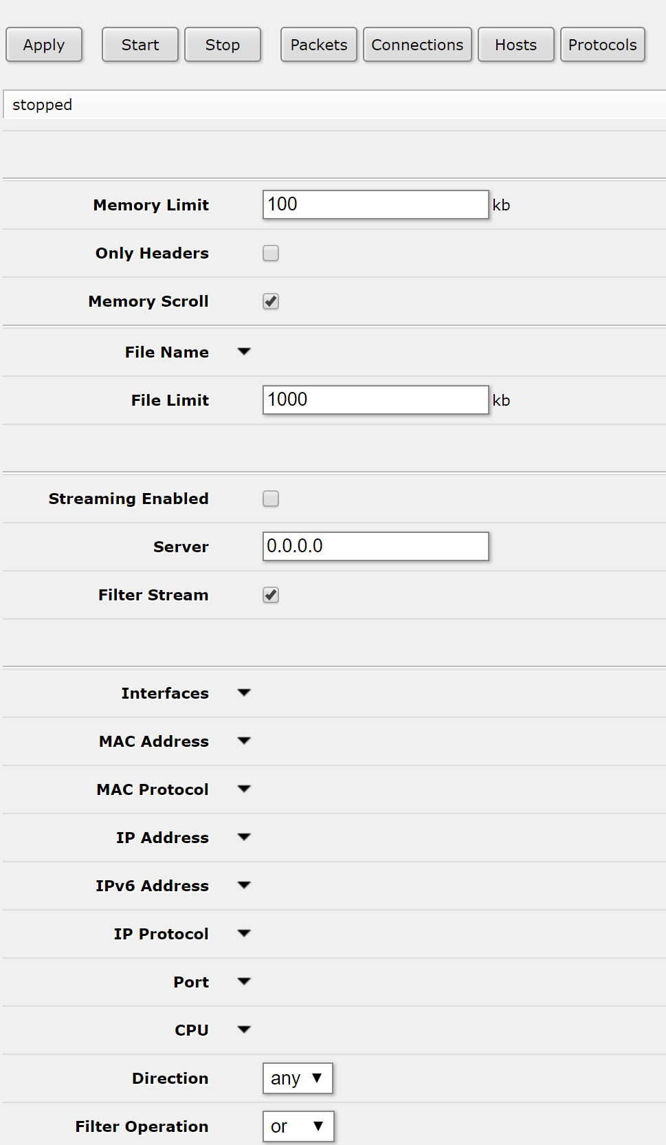

I want to check the traffic between client/server with the packet sniffer that is part of the mikrotik UI (under tools).
What I have done so far:
First Verify that traffic is really going on the dedicated interfaces, for that purpose I have ran wireshark on on the box where the server is and send traffic from the client using the capture filter “udp” on the wifi interface of the server - the packets show in wireshark with “Source” and “Destination” “Protocol” etc. decoded by wireshark and the payloads look ok (well the response from the server is somehow padded with gazzilion of 00s but that is probably because of packet fragmentation of MTU expiration … anyway, it works well and the client can decode id fine - just wanted to mention that if this will help)
Second Start packet sniffer on the mikrotik in the most verbose mode ever: Sniff anything on all interfaces (check the attached sniffer.png for a screenshot). So I do it like this:
  1. start packet sniffer
  2. do a simple UDP communication and
  3. stop it so that the limit of 100kb is not reached.
    For my surprise there is no trace whatsoever of the udp packets in the packets captured by the sniffer …
Third I have tried the trick with streaming the packets to a machine which runs wire shark and using the “udp port 37008” capture filter - same result (I have disabled the “WCCP” as it was clashing with TZSP used by mikrotik to channel the traffic)
So I am sure I am doing something pretty stupid but I cannot figure out what is it?

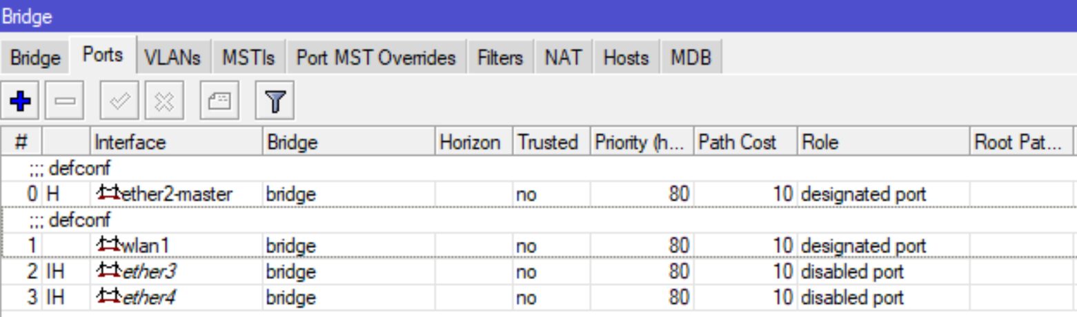

Thanks a lot, that makes more sense - unfortunately somehow the moment I disable default forwarding clients immediately stop speaking to each other (just like it is advertised)
My config is like this:
one bridge named “bridge”
one port named “wlan1” connected to “bridge” you can check “bridge.png”
Any other ideas?
Am I the first person in the world to try sniff communication between wifi clients in the same subnet?
Okay another try: Can someone point me to info how to make the clients talk to each other without using default-forwarding? (Obviously the moment you have default-forwarding the traffic does not reach the router but is handled inside the hardware chip)
