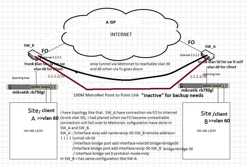

i have topology like in the picture.
i had enable rstp in every bridge. but still looping
for 4.4.4.4 (remote address) had changed to 1.1.1.2

yes i need to run bridge here, would you like to help solve my problem?, maybe give some clue for searching in internet
is it posible just bridge virtual interface like vlan or eoip without bridge real interface (ether1,…) ?. i mean is it posible run without add real interface into bridge (will rstp work ?) to block a virtual interface (became alternate port)?
because when i looked rstp not bocking a virtual interfce became alternate port (role = alternate-port), in my case all interface bridge became dessignated-port and root-port (for eoip from sw_B to sw_a)

Maybe you can use routing instead bridging to get rid of these problems. Do you really insist on the bridges? If so, why?
it is exiting topology buddy, i cant change it, i just can add it or increase it better
