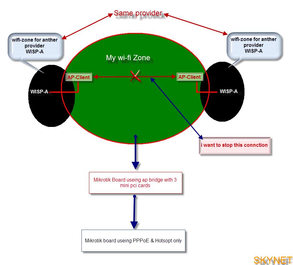

There anther WISP On the outskirts of my network converge
He using my network converges to connect between tow away points
Through my mikrotik board converge.
Please see the attached picture to know my meaning …
This board working only AP Bridge and it connected to
Anther board it working PPPoE &hotspot Server only
How to configurations my board to allow my clients only to be connect my network with PPPoE and Hotspot only in same time stop all anther connections coming out my clients.
or and stop spam AP’s on the networks shown in the picture caption = that uses the my board converges for the benefit of and between the points to reach its own is not annotated your attention please
Note : the Ap client useing my network converge to connected between
I hope I have properly explained to you

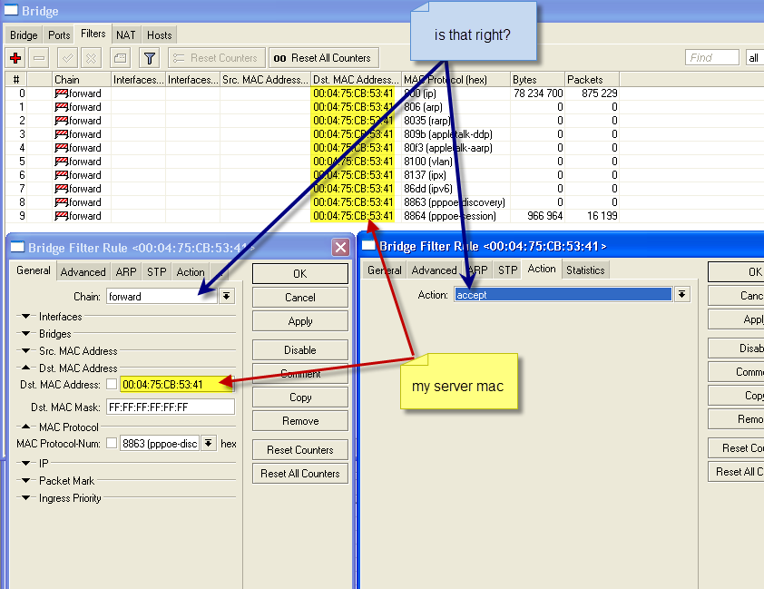

i was added all filter protocols = in accepted from my server mac = is that will be ok and stop anther connections !!! or i need to stop-drop- some protocols ??
