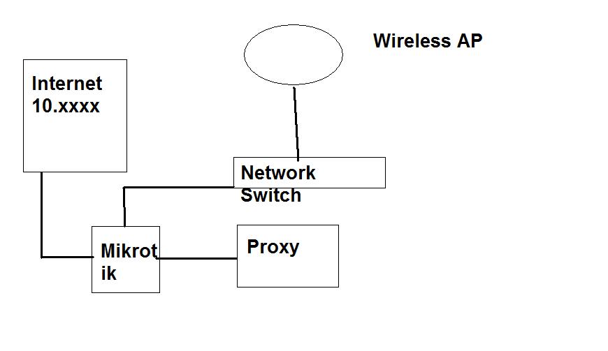

Here is my network
you can just disable intercommunication in the switch, if it’s smart enough. if it’s a dumb switch, you will not be able to block sharing, because communications between users will not even reach the router, they will go though switch
