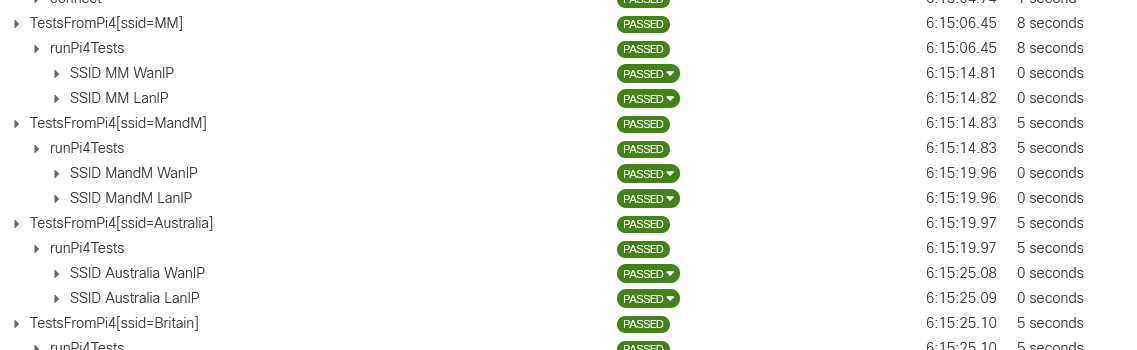

I found one, which is Cisco pyATS. You can write tests in python, it will run them and display results in a GUI. I’ve managed to get it to login to a device and run a couple of SSH commands. It doesn’t have MT support, just trying to get it to SSH to an MT device now. This is an example of a test
@test
def simple_test_1(self):
    self.parameters['appmachine'].execute("ping -c 1 192.168.1.1")
I have got something functioning at least. It hasn’t been smooth sailing. The syntax isn’t intuitive, the documentation is terrible and chatgpt has lead me down the wrong path a lot. But I have got it checking all the LAN and WAN IPs for a range of subnets. I wrote a basic addin to get it to work with MT, so I can run linux and MT commands and parse the results. It’s really just a matter now of going though the grunt work to write all the tests. It has already found one issue with the network
