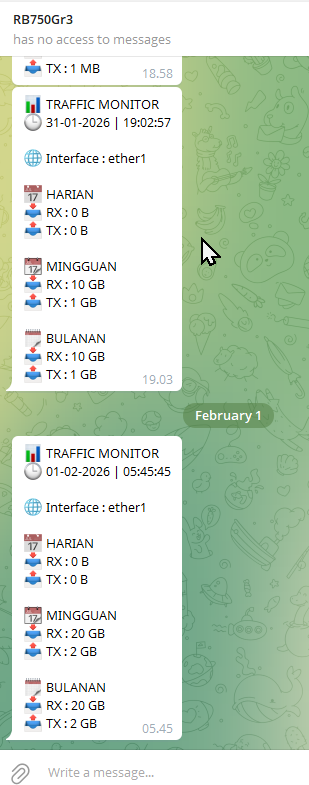

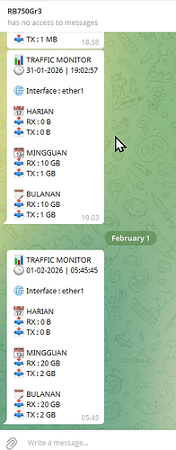

“I found the solution: I created a script (with AI’s help) and a scheduler, then sent it to a Telegram bot.”
