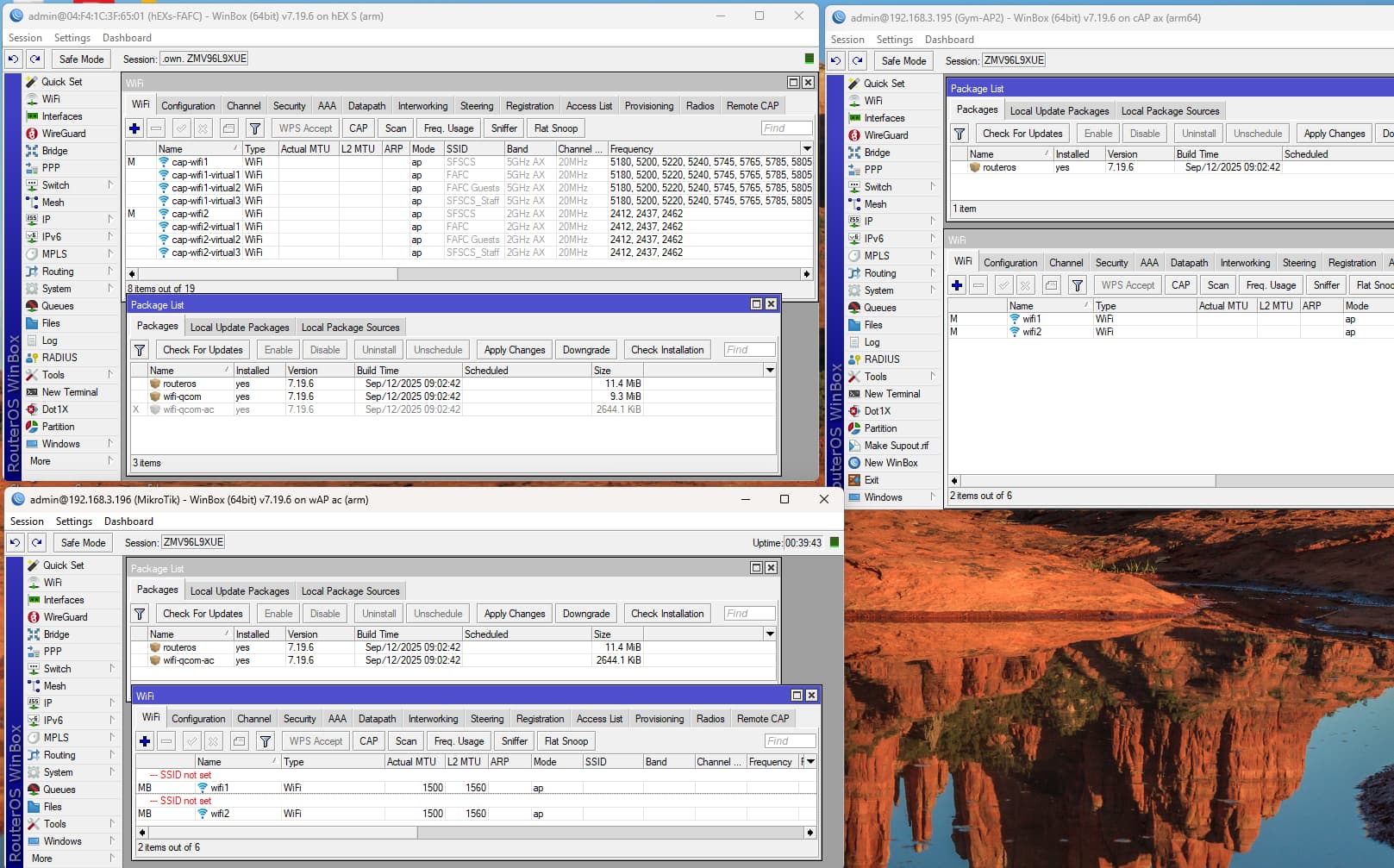

I am so confused right now LOL. What changes do I have to make on the hEX S? I see CAPSMAN
the wAP AC has the right version of code now. Do I make any changes on the AX?
All three have the “WiFi” option available in winbox. I can see my WiFi settings in the hEX S but the cAP AX no longer sees any CAPSMAN config being sent.
OK, installed wifi-qcom (not wifi-qcom-ac) back on the cAP ax and ssid’s are back on cAP ax
(I was fiddling before I started to read thru the thread).
What should be installed on the hEX S? Should it be wifi-qcom or wifi-qcom-ac?

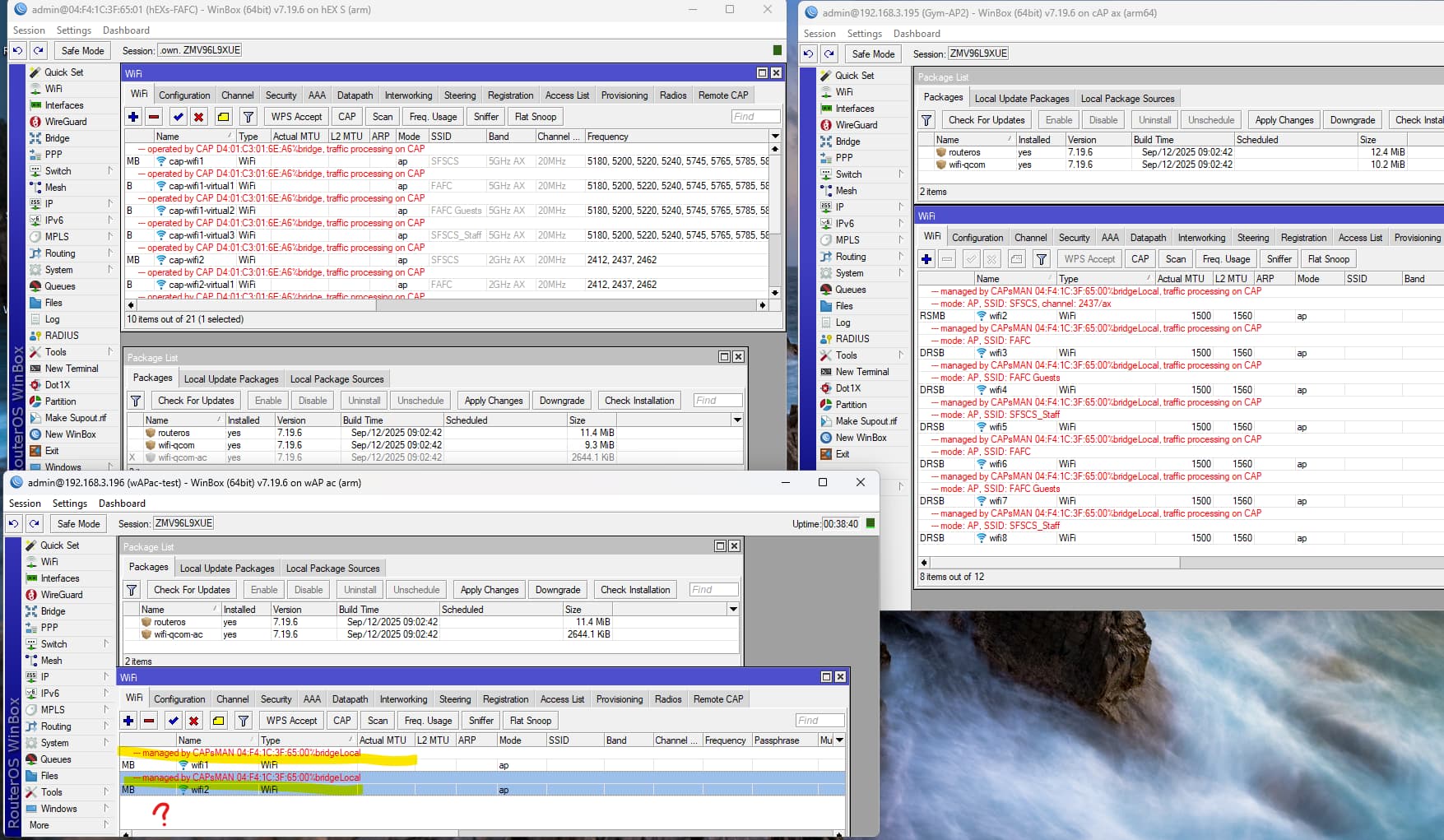

So the wAP ac (arm) shows radios (wifi1 and wifi2) are not greyed out anymore though the ssid’s say “SSID not set”.
”CAP” checkbox is enabled on both wAP ac and cAP ax. Not enabled on hEX S.
I will post up latest image shortly.

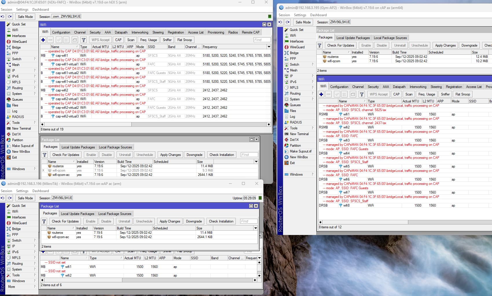

Ok, after holding the caps reset on wAP ac, now I get “managed by capsman”, but no ssids show up in the wAP ac
I think I am going to throw up now. What an absolute wireless/wifi word salad. What a mess :grimacing:

cAP ax
# 2025-10-08 07:08:00 by RouterOS 7.19.6
# software id =
# model = cAPGi-5HaxD2HaxD
# serial number = <EDITED>
add admin-mac=D4:01:C3:01:6E:A6 auto-mac=no comment=defconf name=bridgeLocal \
    port-cost-mode=short
/interface wifi datapath
add bridge=bridgeLocal comment=defconf disabled=no name=capdp
/interface wifi
# managed by CAPsMAN 04:F4:1C:3F:65:00%bridgeLocal, traffic processing on CAP
# mode: AP, SSID: SFSCS, channel: 5825/ax
set [ find default-name=wifi1 ] configuration.manager=capsman .mode=ap \
    datapath=capdp disabled=no
# mode: AP, SSID: SFSCS, channel: 2437/ax
set [ find default-name=wifi2 ] configuration.manager=capsman .mode=ap \
add bridge=bridgeLocal comment=defconf interface=ether1 internal-path-cost=10 \
    path-cost=10
add bridge=bridgeLocal comment=defconf interface=ether2 internal-path-cost=10 \
    path-cost=10
set udp-timeout=10s
/interface ovpn-server server
add mac-address=FE:9C:88:2B:06:54 name=ovpn-server1
/interface wifi cap
set caps-man-addresses="" certificate=none discovery-interfaces=bridgeLocal \
    enabled=yes slaves-datapath=capdp
/ip dhcp-client
add comment=defconf interface=bridgeLocal
/ip ipsec profile
/system clock
set time-zone-name=America/Los_Angeles
/system identity
set name=cAPax-test
wAP AC
# 2025-10-08 07:09:00 by RouterOS 7.19.6
# software id =
# model = RBwAPG-5HacD2HnD
# serial number = <edited>
add admin-mac=48:8F:5A:F5:A4:56 auto-mac=no comment=defconf name=bridgeLocal
/interface wifi
/interface wifi cap
set certificate=request discovery-interfaces=bridgeLocal enabled=yes \
/ip dhcp-client
/system clock
/system identity
set name=wAPac-test
I have place all three device configs within the preformatted option you requested.
Thank you for Looking!
Only as a reference for further analysis:
  1. the hex S has MAC: 04:F4:1C:3F:65:00
  2. the Cap Ax has MAC: D4:01:C3:01:6E:A6
  3. the Wap Ac has MAC: 48:8F:5A:F5:A4:56
Cap Ax has:
'# managed by CAPsMAN 04:F4:1C:3F:65:00%bridgeLocal, traffic processing on CAP
(so the CAP Manager is the hex S), good, and it also has:
'# mode: AP, SSID: SFSCS, channel: 5825/ax
and
'# mode: AP, SSID: SFSCS, channel: 2437/ax
(I would say "good")
The Wap Ac has:
'# operated by CAP 48:8F:5A:F5:A4:56%bridge, traffic processing on CAP
(so the CAP manager is "itself" :confused: )
And it has no mode AP,SSID and channel
(I would say "wrong")
Then the hexS has TWO /wifi sections, one with 2 interfaces ( wifi 3 and 4) operated by the Wap Ac:
and one with 8 interfaces operated by the Cap Ax:
'# operated by CAP D4:01:C3:01:6E:A6%bridge, traffic processing on CAP
So WHICH device is actually the CAPSMAN?
It seems to me like you somehow created some sort of circular reference on the Wap Ac.
I bolded to highlight them the managed vs. operated.
I wiped the wAP AC with “no default config” and reloaded, set as cap, reloaded and it still shows no ssids being sent to wAP ac from hEX. I have only one capsman configured on hEX, other two devices do not have capsman configured and are both set as cap.
But does it say operated or managed?
And if managed, is it managed "by CAPsMAN 04:F4:1C:3F:65:00%bridgeLocal"?
