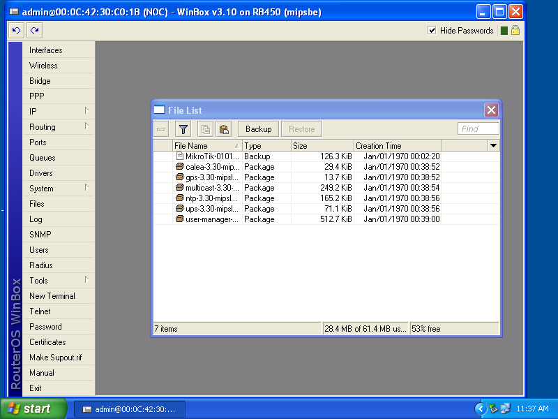

Attached are the files uploaded from all_packages-mipsbe-3.30.zip to RB450 file folder. What to do next Bro? What to do old files in this folder? Thanks.
Just reboot. I do not believe you need really all packages. System,advanced tools, dhcp, routerboard and security should be enough. But anyway, just reboot as i wrote recently.
Okay! After reboot i got this in file windows. What happened to other installed packages? And what to do next Bro it didn’t changed the routerOS version? Thanks.
It tried to install 3.30. Something should be in log…
