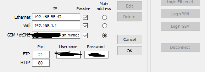

I added a screenshot of the normal setup for the datacollector to get the sound files.

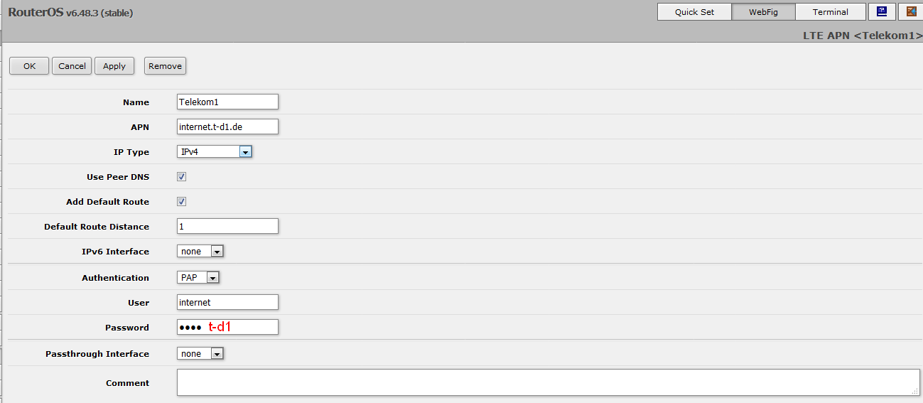

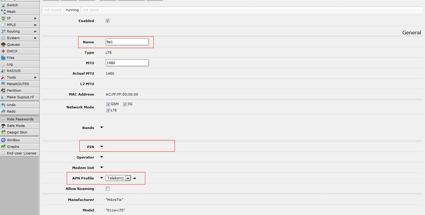

Afterwards I went to inferfaces and added an LTE APN
I filled in all the details of the provider:
Afterwards I have Telekom1 in the APN list

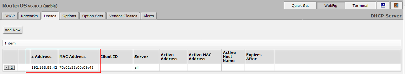

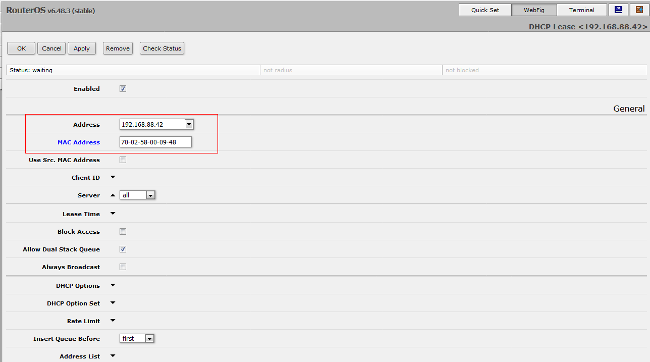

In the DHCP server list I added new leases to link the Ethernet address to the MAC address

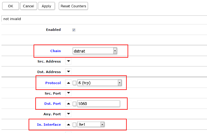

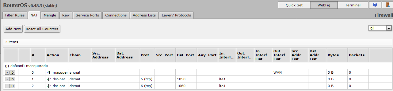

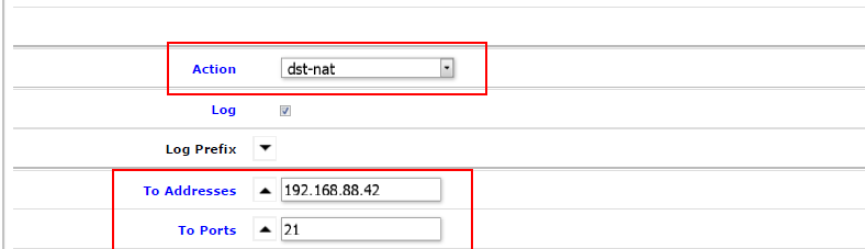

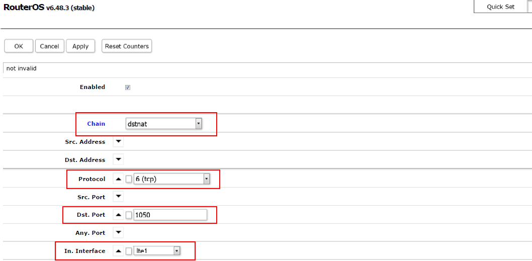

After this I added dst. ports for 1050 and 1060:

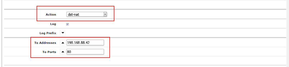

Setup for Port 1050 to 80
Setup for Port 1060 to 21

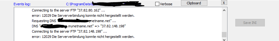

To describe the issue further:
On another PC which is online connected with the internet tries to get the data
via FTP protocol from the sound recorder.
The tool tries to reach the sound recorder through the IP Cloud name
and receives also the IP address of the SIM card within the modem.
Unfortunately error 12029 occures that the server connection couldn`t be estabilshed.

Attached the solution for this issue.
I mixed up 21 and 80 in the FTP tool to get the data.
Instead you have to use for sure the 1060 and 1050.
Now all is working fine.
