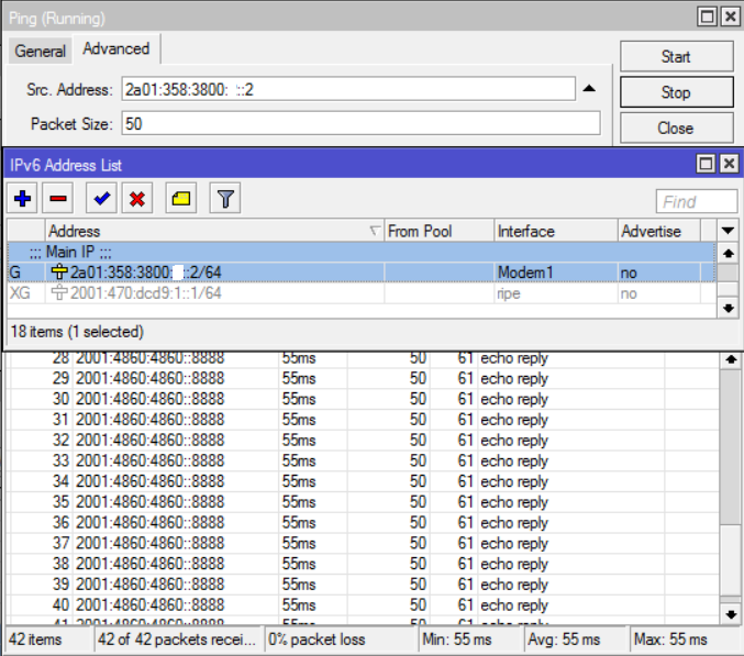

We have mikrotik 1036-12G-4S router and we made bgp connection with our isp. Now we have IPv6 block 2a01:358:3800:X::/64 . I use to check internet connectivity by /tools/ping and it is ok(attached). I Create a DHCP server and my computers and Mikrotiks get ip address from Main mikrotik but I can’t ping and get internet. (I only can ping devices.)

we have some public ipv6 and done bgp between us and our ISP. I tried to get internet by IPV6 and succeed.
