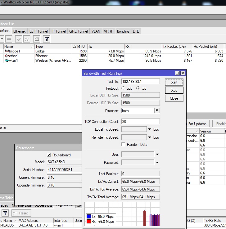

Hey, nice troughput, can u show the configs used in this ?
to Inox “the forum expert”: yea of course dude u can do that duplex but not in one way (150mbit) - did you read first post , in best condition in real world Ill give u 90 plus SXT-r2 is limited to 100mbit Lan
I don’t think that there is any possibility for you to reach 50mbit with SXT. You should try something else.
