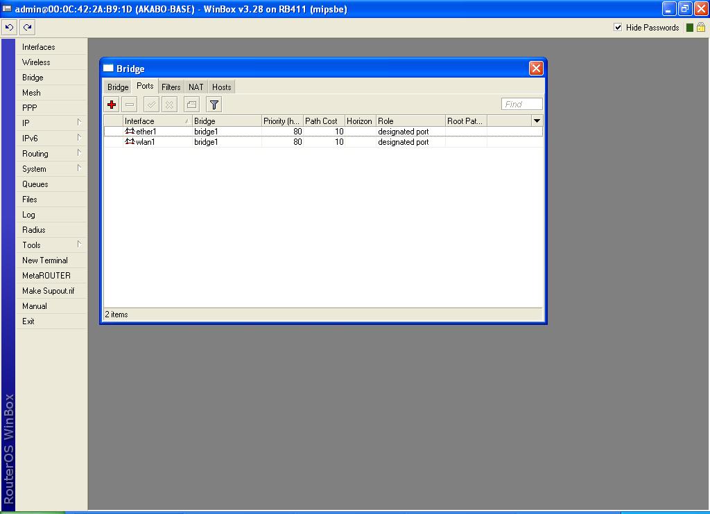

I have been trying to use a mikrotik radio as a CPE so that after connecting to the base radio, it will get ip direct from the base, that i can access the internet directly.
What i want to say is that, just like other CPE, as sson as they connects, the ip goes to the computer connected to it, but in the base of mikrotik, it does not happen even after bridging the two interface, yet thre computer will get ip address but will not connect to the internet unless you make the mikrotik CPE to be a router on its own.
Find the attached pictures of what i did yet the computer could not browse.
Did i do anything wrong or i am missing something.
Your urgent response is needed.

Dunga,
You are using station mode, but you have tied both interfaces to a Bridge.
Someone shoot me if I am wrong, but you cant do that.
Station mode has to be routed… (no internal bridge)
you need gateway and routes added, and seperate IP ranges on both the wlan and eth.
Or you can go the Pseudobridge mode and use a bridge to link the 2 interfaces.. With 1 IP against the bridge only.
Again gateway/route needs to be added to next hop/gateway.
