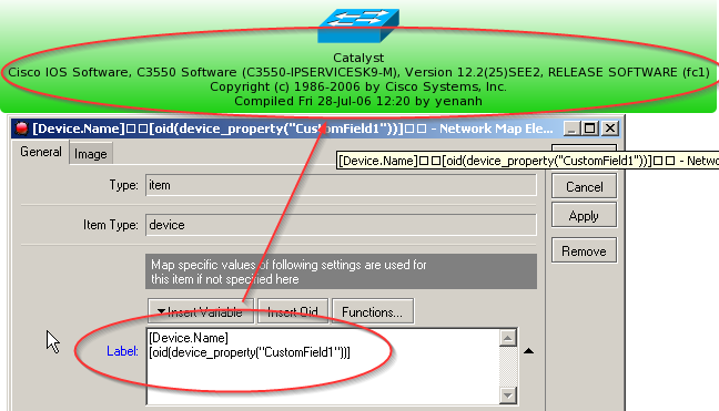

I have solution, and this is not a trick :slight_smile:
Label code:
[Device.Name]
[oid(device_property("CustomField1"))]

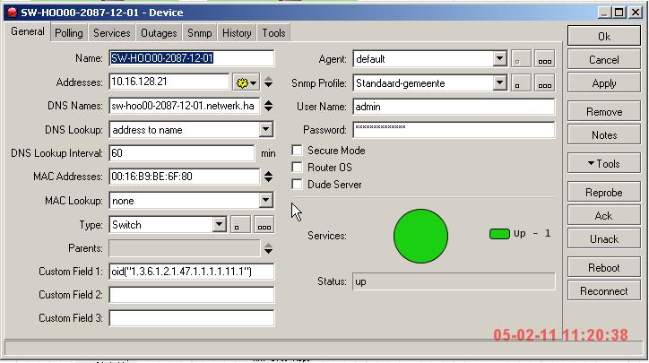

The first screenshot shows the Device-settings of the switch I’m trying to get this info from.
I’ve nice and smooth added the OID in the CustomField1 including the normally used notation with the Dude (as in: preceeded with oid etc).

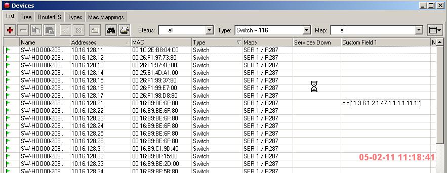

The second screenshot shows the Devices-panel which I was talking about, including the sorting properties I decided I want to have.
Here you can see that in the column of CustomField1 an OID is returned instead of it’s value (what would have been the serial here..)
