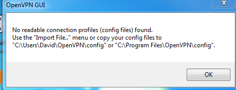

Hello ,
I want to start using in my office OpenVPN
I have setup everything in my router and I want to check
I have download
https://openvpn.net/index.php/download/community-downloads.html
than what?
where is the connection?
how do I connect to the router?
can someone help?
when I try to run the shortcut I get this:
why?
in all the site I have visit - it say it should open a popup to enter user\pass\ip
like this:
Thank ,
You need to create config file. It’s a text file and could look like this:

I don’t exactly remember what all options do (check the manual, there also many others), but this one does work with RouterOS OpenVPN server. Name it something.ovpn and save it to config directory.
this is a start :slight_smile:
