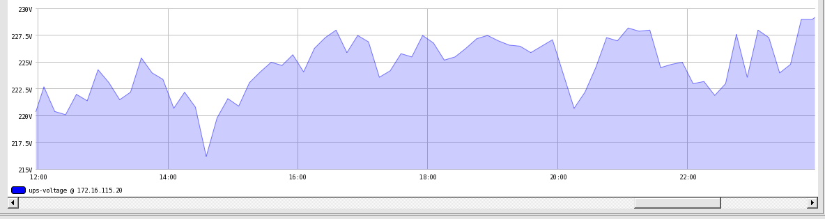

Did not work for me with ROS5.2 so I post my modifications. I use two probes, one for battery charge and the other for line voltage.

ups_line_voltage
round(
string_substring(ros_command("/system ups monitor ups1 once"),
string_find(
ros_command("/system ups monitor ups1 once"),"line-voltage")+13,
4)
Type: Functions
Agent: server
Available: ups_available()
Error: if(ups_status(), “”, “down”)
Value: ups_line_voltage()

I can not get any information about ups input and ups output like input/output voltage.
I mean something like this:
