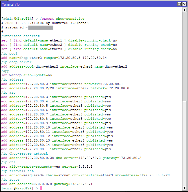

Here is my test config to confirm the above is working as intended:
Screenshot
Here ether3 is the WAN interface, ether2 is the servers interface, and the address range is 172.20.80.0/28 instead of 1.10.100.112/28.
