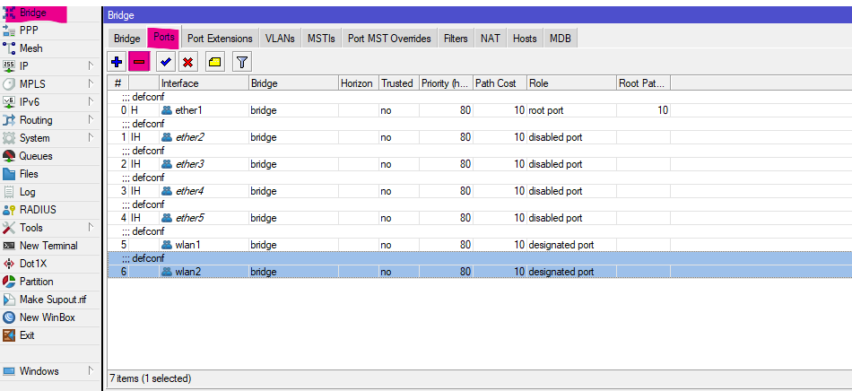

So if your looking for validation: you should be able to remove it from the bridge, with the “-”, as shown in your photo - that be the first setup. Since you’re just deleting a “reference” to the port in the Bridge>Ports – the interface will still be in Interfaces/Wireless after you remove it.
Once wlan2 is remove from Bridge>Port, wlan2 is just a L3 interface. As such, will need it’s own IP address… Assuming you want a NEW subnet, use IP>Address, selecting the wlan2 interface, picking what your need or something like 192.168.99.1/24. You can then add a 2nd IP>DHCP Server for the wlan2 interface, there is a “DHCP Setup” button where you can pick wlan2 that do most of the work for you.

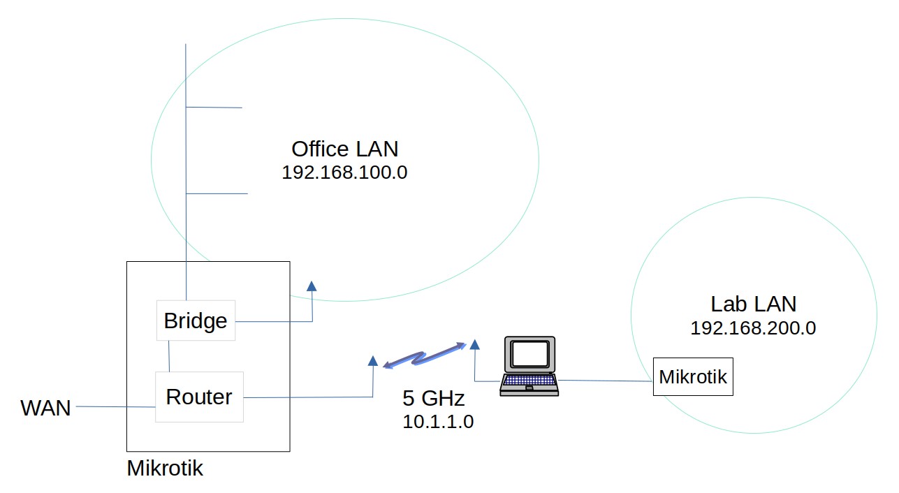

This plan is to offer a software developer remote access to the test lab via port forwarding in the WAN router and TeamViewer in the notebook on the 5 GHz Wi-Fi radio . I plan to apply security measures (up the wazoo, as we said in the old neighborhood) with ACL, MAC filtering, etc.–suggestions welcome. The Mikrotik router in the lab connects to devices under development and a VoIP installation.

Sorry for the slow reply. Just posted the network topology.

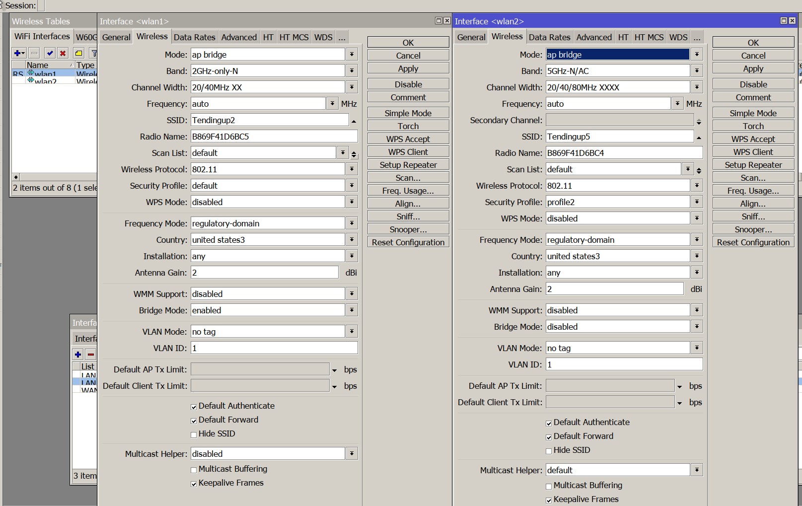

Thanks Amm0, your info moved me along considerably. Only the 2.4 GHz radio connects from the LAN bridge to the notebook. The 5 GHz radio in the MikroTik is not on the bridge but otherwise configured the same, including the “Mode” in “Advanced Mode” set to “AP bridge,” with the exception of an additional (blank) field for wlan2: Secondary Channel. I hope that is not the same bridge for both radios :-0 ScreenCap attached. If this is not the configuration you asked for please advise.
The notebook either can’t find the 5 GHz radio on the MikroTik or the IP configuration is not available (on separate attempts to connect).
And another thank you to McSee for how to remove wlan2 from bridge.
Basically if the 5Ghz interface is not in the list on Bridge>Ports, it is not in any bridge. That setting (Wi-Fi “Bridge Mode”) effects how the wifi radio deals with the fact it may be in a bridge, but it doesn’t put in one.

BTW “ap bridge” is what you want in both cases.

OR, if it the Wi-Fi just doesn’t connect in the first place. You might try enabling that “Bridge Mode” on the 5Ghz interface, it certainly won’t put in the bridge, but the Mikrotik may need it to provide DHCP etc – not the expert on the particulars of that setting AND never changed it before (e.g. just always left it on if using “ap bridge”, even when the wifi interface was NOT using the bridge interface).
Have configured wlan2 with a separate security profile. When creating a separate DHCP server instance for wlan2 that line in the table appears in red: invalid. “RouterOS by Example” (2nd Ed., p. 25) states that an interface placed on or removed from a bridge makes the DHCP server for that interface invalid. Is the Mode selection of “AP Bridge” invalidating the DHCP server? Is the order of setting up various windows critical? Of the modes in the drop down menu in the “Interface ” window there isn’t an obvious choice for a mode to set up a wi-fi radio on its own subnet. What am I missing?

I think the reason why you’re having trouble with the DHCP Server is because “wlan2” is still in listed in RouterOS’s Bridge>bridge1>Ports — “wlan2” (assuming that the “lab wifi”) should NOT be a port in what I describe. Pretty sure you want “AP Bridge” – there, the word bridge in name refers to the fact it handles multiple wireless clients (which is was APs do: they “bridge” all connected wireless devices, but on that interface only). With “station mode” is the reverse of “ap bridge” - that’s a single connection to another Wi-Fi AP, and you’d typically have a DHCP Client on a “station” to pull an address from another network/subnet. With all the other Wi-Fi modes to deal stuff in-between.
To bridge a wi-fi interface, with other ethernet ports/tunnels/etc, that requires the wifi being listed as a “port member” of a RouterOS bridge. And, a wi-fi interface is a “separate subnet” automatically, unless it’s it’s in bridge. (e.g. “/interface bridge ports print” should NOT show wlan2 here).
