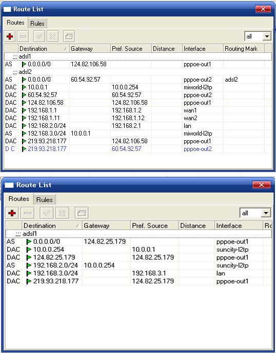

IP : 192.168.2.0/24
L2TP : local ip : 10.0.0.254
IP/Routers list : 192.168.3.0/24, gateway 10.0.0.1
my 2nd cafe
IP : 192.168.3.0/24
L2TP : local ip : 10.0.0.1
IP/Routers list : 192.168.2.0/24, gateway 10.0.0.254

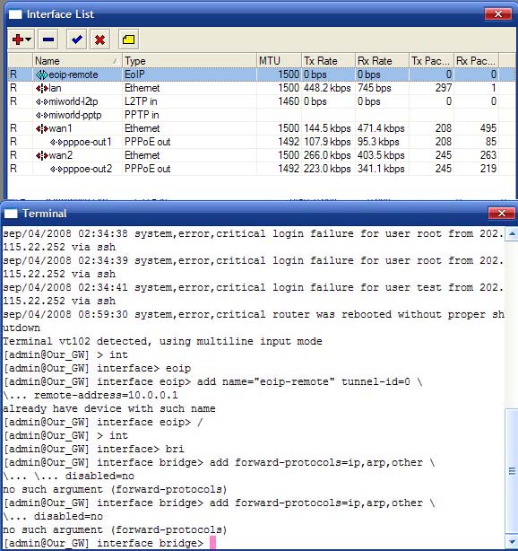

i found guide from below, error in 2nd state?? what is wrong from guide?
http://www.mikrotik.com/documentation/manual_2.7/Interface/EoIP.html
first state
1st cafe
[admin@Our_GW] interface eoip> add name=“eoip-remote” tunnel-id=0
... remote-address=10.0.0.1
[admin@Our_GW] interface eoip> enable eoip-remote
2nd cafe
[admin@Remote] interface eoip> add name=“eoip” tunnel-id=0
... remote-address=10.0.0.254
[admin@Remote] interface eoip> enable eoip
second state
1st cafe “here i get error”
[admin@Our_GW] interface bridge> add forward-protocols=ip,arp,other
... disabled=no
[admin@Our_GW] interface bridge> port set “0,1” bridge=bridge1
2nd cafe “here i get error”
[admin@Remote] interface bridge> add forward-protocols=ip,arp,other
... disabled=no
[admin@Remote] interface bridge> port set “0,2” bridge=bridge1

i found the one from other site, i try to follow the configure but no working this configuration!! what is wrong?
1st cafe
interface eoip add remote-address=10.0.0.254 tunnel-id=2 mac-address=FE:FD:00:00:00:04
interface eoip add remote-address=192.168.3.1 tunnel-id=1 mac-address=FE:FD:00:00:00:03
interface bonding add slaves=eoip-tunnel1,eoip-tunnel2
ip address add address=10.0.1.1/24 interface=bonding1
2nd cafe
interface eoip add remote-address=10.0.0.1 tunnel-id=2 mac-address=FE:FD:00:00:00:02
interface eoip add remote-address=192.168.2.1 tunnel-id=1 mac-address=FE:FD:00:00:00:01
ip address add address=10.0.1.2/24 interface=bonding1
pls help and point to me!
thanks
