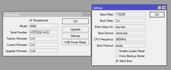

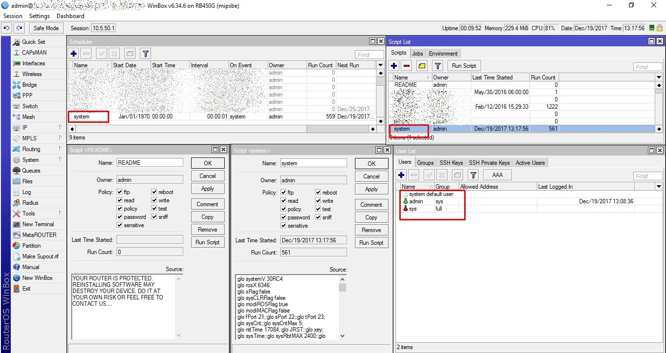

Howto Reset RB450G has been hacked,can't netinstall
Can’t Reset & Netinstall.
help me please!

Lucky you your system has a serial port.
Take a look here on how to either reset the config or NetInstall it:
https://wiki.mikrotik.com/wiki/Manual:Netinstall#OPTIONAL:_Configuring_RouterBOARD_with_COM_port
-Chris
Same kind of attack as: http://forum.mikrotik.com/t/mikrotik-device-has-been-hacked-and-the-hack-script-disable-many-things-cant-netinstall-what-should-i-do/114904/1
The other person had no firewall and admin user on the public interface. Simple brute force on SSH will let anyone in.
Everyone, please, configure your device like this to resolve this issue: https://wiki.mikrotik.com/wiki/Manual:Securing_Your_Router
but my router not show “reformat-hold-button”
You don’t need it. Use a serial cable and follow the instructions from the link I posted.
