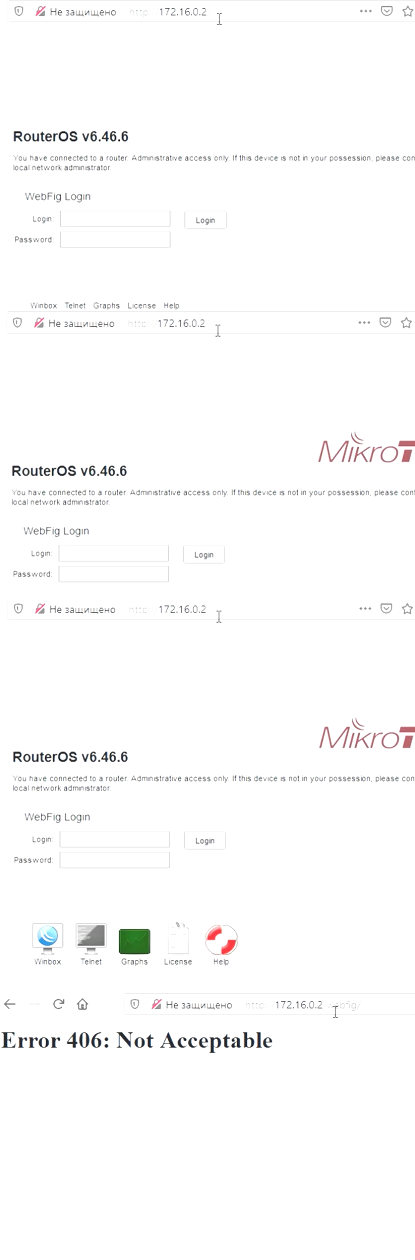

If I try access webfig of RB4011 over L2TP/IPSEC link I get
"Internet Explorer cannot read this webpage format
HTTP 406 " (with IE8)
or “Error 406: Not Acceptable” (with FF75).

Webfig logon page displays briefly but then turns to Error 406: Not Acceptable.
Please see screenshots below.
Why does it behave like that?

To me, the most likely reason would be an MTU issue, where the request packet from your browser gets truncated. Does the 406 pop up immediately or after some time?
It appears after some time - logon page gets dispayed for a split second, and then 406 see screenshots above.

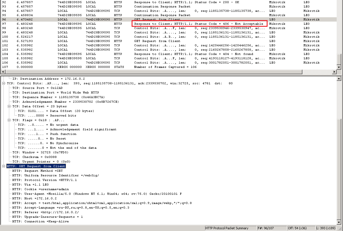

Should I try packet sniffer?
p.s. I can download files from 'Tik using Winbox, so it does not seem like MTU issue to me
Of course packet sniffing makes sense, but only if you use http, not https.
This is what I get in capture and no logon is registered in 'Tik log
