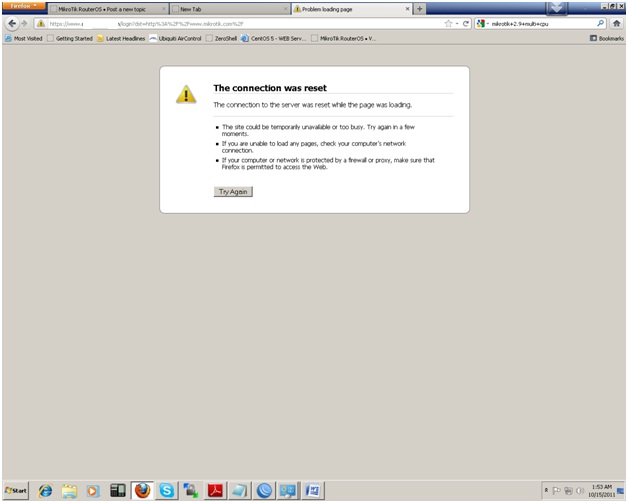

l now have an issue with any-ip feature or the universal nat feature.
The hotspot server has https enabled.
hotspot client with the static ip address(out side our subnet) already set can use the hotspot without problems.
But if he has proxy address already set in his browser then he Gets Error.
This error occurs whether ip was by dhcp or he already had static ip (outside or subnet)
This is the error on the browser side
https://www.makercx.com/login?dst=http%3A%2F%2Fsearch.bearshare.com%2F
But if he connects without the proxy and with or without static ip hotspot works.
