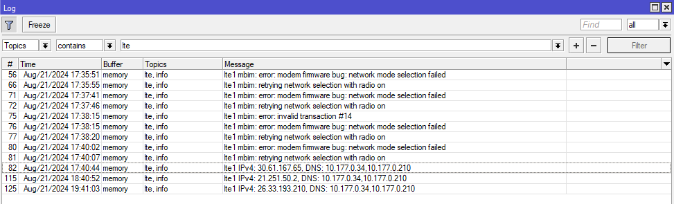

Interestingly it’s an mbim interface (didn’t know that this even exists on an E3372?) and in RouterOS 7.15.3 it shows up as LTE interface. Now here is the thing: It’s generally working, i.e., I can establish a connection. However, it’s hardcore unreliable. Once connection drops, it takes huge efforts to get it up again. Unplugging/plugging the stick or rebooting RouterOS doesn’t seem to work. Here is my log:
It took over 5 minutes until connection was established and this is just the best case. Sometimes it’s hours.
The errors are always similar:
  • lte1 mbim: error: modem firmware bug: network mode selection failed
  • lte1 mbim: retrying network selection with radio on
  • lte1 mbim: error: invalid transaction #14 (sometimes other numbers, such as #9)
Any advice to get this working properly?
