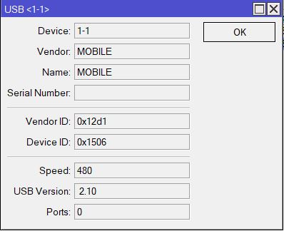

Huawei E3372h in StickMode
i am new to Mikrotik, i own a RB962UiGS-5HacT2HnT
I have a dynamic public IP on my Huawei E3372h and i want to attach it directly to my Mikrotik to avoid Double NAT.
Compatibility list shows that it should work
https://wiki.mikrotik.com/wiki/Manual:Peripherals#Cellular_modems
I can’t see a LTE Interface, is this OK in Stick Mode? I am a bit confused :slight_smile:
Can anybody help me please, what do i have to configure?

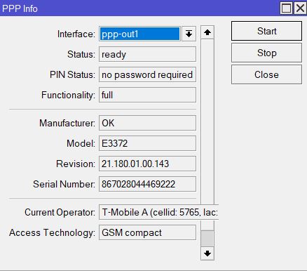

/interface ppp-client
add apn=mass.at disabled=no info-channel=1 name=ppp-out1 port=usb1

when you see usbx device then e3372 is in modem mode, speed is limited via emulation of serial interface… but your connection will be done by PPP-OUTx who give IP to MikroTik and PASSTHROUGH can be use to pass that IP to other router in your network.
when you see ltex device then e3372 is in hi.link mode, own Router. Nat by Nat. HiLink is router and this give full speed and works perfect. With modded firmware you can unlock DMZ, adb, API etc. I not know that Hi.Link have own passthrue to bring IP to MikroTik - this is not related at Mikrotik and should be done by E3372 itself because he have IP and must give it to other device.. or use DMZ.
