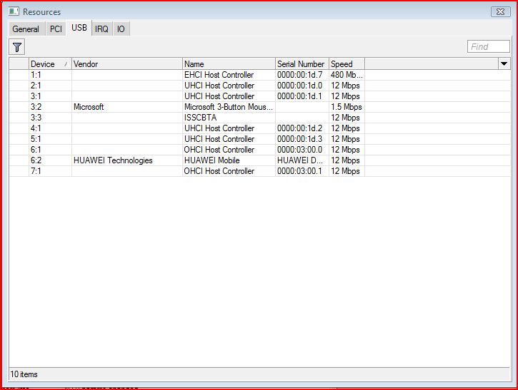

I have a 3G card within a converter in a PC running ROS 3.6
Seems ROS does NOT pick up this card as there are no serial ports available. (I disabled the motherboards)
Only USB ports.
The converter itself does work as ive used a pcmcia wireless card within it in same pc with ROS.
The card has got support within ROS3.x from research so…
What could be issue here?
How surprised can you imagine i was when i decided to out of utmost frustration selected the usb as port and it dialed out and was working!
WTF!!!
This card is a PCMCIA card surely it would be a serial port not usb?!
Well here is the odd truth…
Well, at least it’s working…
I think it’s because that the PCMCIA port runs as a USB device, like a USB card reader and so on…
If you look at a laptop the mouse, keyboard, soundcard, wireless, bluetooth, (and new laptops with seriel/parallel port) actually run as a USB devices.
It’s the best way to build hardware today :slight_smile:

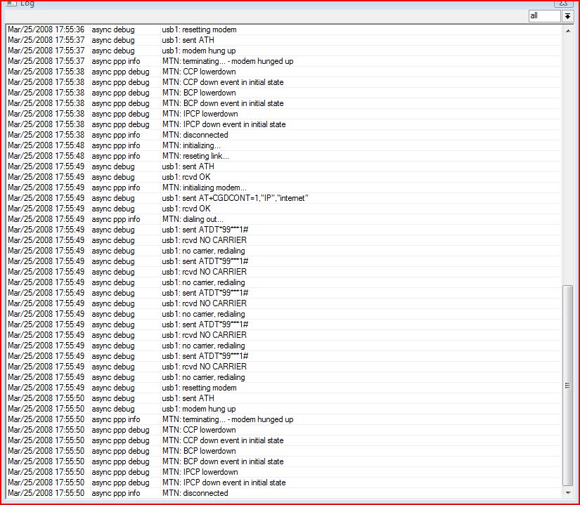

I keep on getting this darn
usb1: rcvd NO CARRIER
even if i try a valid normal line…
HELP!
Reset the damn thing and set it up exactly the same, now it works again…
grrrrrrrrrrrrrrrrrrrrrr…

I did the whole /terminal system serial-terminal thing to test each at command…
I also did this test in windows using hyperterminal.
The results was interesting as the same commands work on windows, but not ROS.
I was able to answer a incoming call and such with the ROS setup but just not ATDTinsertnumberhere
The dreaded “NO CARRIER” prevales!
However windows works.
No idea what could be difference, very interesting problem.
