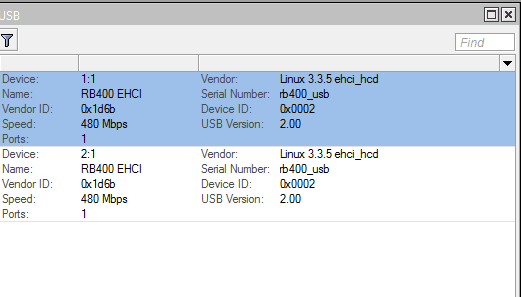

I have two RB953GS-5HnT and I have problem with me909 modems. Whatever I did, routers does not recognize the modems. when I check in system/resources/usb modem is not listed.

I connect the modem to the routers in both sockets to confirm that same fault happens in both
I change the type in system/routerboard/usb to mini PCIe
I perfrorm a usb power reset for 5 seconds.
I install the LTE package (I was not sure if this must be installed I just did it because of the name)
All this performed in v6.39.1 After that I downgrade in v6.35.1 to check if there is a bug in this version but same result.

I tried several things but finally dealer replaced the modem (with Huawei ME909u-521 if I remember correct)
