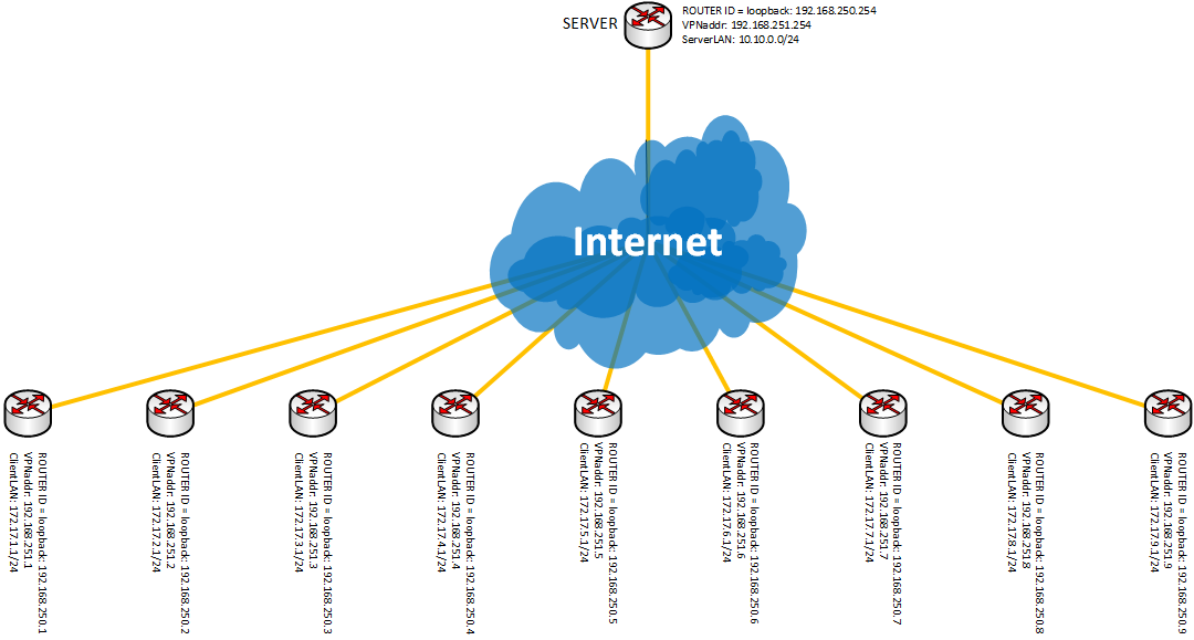

I’m trying to build a Hub and Spoke Construction (as you can see in the Picture).
Now following works:
  • WireGuard is connecting from Clients to Server
  • I can Ping the Server-Addresses with the Clients and so on.
  • ONE Client is connecting to the Server with OSPF (as a Neighbor, State: Full).
  • The Routing Server-Client / Client-Server works to this one Client, wich is shown as Neighbor (State: Full).

Looks like you have OSPF set to type=ptp. From OSPF’s perspective, the Wireguard interface is a single interface even if more than one remote peer can send packets to it. In P2P mode it’s going to assume that there is only one peer on the interface and use the usual multicast/broadcast mechanism. Whatever router connects first is likely to be the one that forms the neighbor adjacency and everything else is out of luck.
It looks like you are fine with a static enumeration of the peers since you’ve configured /routing ospf static-neighbor but I’m pretty sure that doesn’t take effect for interfaces in P2P mode. In type=nbma mode, the neighbors will be formed using unicast hellos so that should make sure each configured peer on the wireguard link gets one.
Thank you so mouch, now it works!
