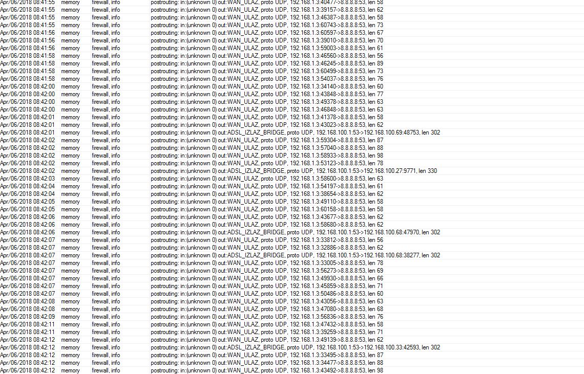

Now what i dont understand is that mikrotik constantly sends outgoing port 53 packets to google server 8.8.8.8(Its set as main under IP>DNS), making 100gb of upload traffic in only one week! Dont understand why its constantly sending this requests, dns caching is working properly it should only ping/send requests to DNS server when new address is requested or cache expires.

2. can you sniff the uplink port into a .pcap file, filtering on UDP port 53, and see what the queries ask for using Wireshark?
I do have alot if domains under adress-list, to control windows update servers and similar, but im using 100% the same address list in about 20 locations, and exactly the same clone of HAP AC configuration, and it doesnt happen on any of them.
Wireshark shows all standard query packets, and gets responding ip addresses resolved back , but i do see them repeating, even it already got proper ip adresses reported back, and domain and ip exist.
Still doesnt make sense, if it does return proper IP why is it repeating requests and not simple cashing it?Cache size is enough and i set it to 60048KiB, while in use its only 900KiB.
