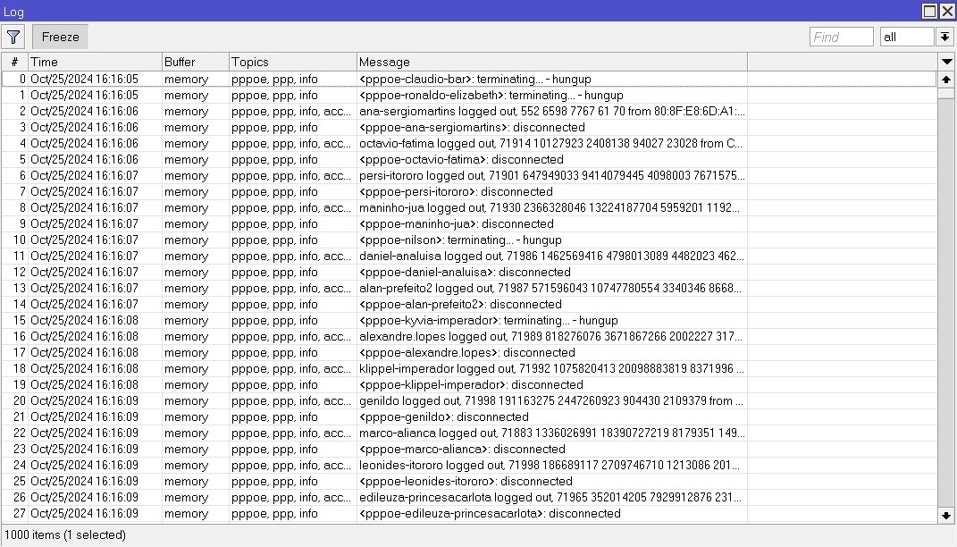

I have a ccr CCR1036-8G-2S+ 6.49.17 (stable)
And I did an update because it was turning off the ports and turning on and dropping all the clients on the pppoe server.
What could it be?
What could it be?
problem update with attached image,
it disconnects all ports and doesn’t let me see certain
things in mikrotik such as interface, firewall, etc.

in the end a jpeg helps little.
