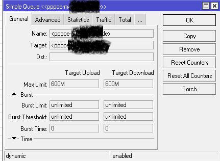

the device is beeing used as PPPOE-server only for fibre clients.. around 800 sessionas on this device.. CPU work loads average 10 to 15% max on peak times.. with average 1.5gbps traffic download..
i saw that my default queue on the pppoe-server profile uses.. the default parameters below.. and i also saw a wireless default queue.. but i guess is for wifi mikrotik devices correct? any ideias on how can improve this?
all 800 clients have average speeds fibre pppoe 300mbps and 500mbps..
we have wifi6 AX routers on clients side.. over fiber ONU devices.. vlan tagged.. pppoe running on the wifi6 ax device..
we plug pc on ethernet cable of wifi6 router.. and speeds normal 350mbps download and upload on 300mbps profile.. and 550mbps download and upload on 500Mbps profile..
when we test on wifi6 AX phone or wifi6 compatible notebooks.. average speeds are 250 to 400mbps max download.. and uploads allways go 550mbps normal..
we tested removing pppoe and setting up static IP on device and connect via static ip directly on another 1036 ethernet interface.. with no limit speeds.. we got 940mbps download on cable straight connected on the wifi6 routers.. and we got around 850Mbps max wifi on download and upload.. on the same phones S22+ and motorola edge30 devices connected on wifi6 on the AX1500mbps router.. but when we switch back to pppoe-client.. wifi speeds drop down to 250mbps up to 400mbps max.. same speeds we get on average wifi ac 5ghz phones..
Our pppoe-server have setup de default-queue from mikrotik
0 name=“default” kind=pfifo pfifo-limit=50
and our ISP ERP system uses radius connection and it forwards to mikrotik the simple-queue with the correct speeds 500M and 300M .. no burst enabled on the simple queues like the pictures below attached.. i am not sure if this could be some sort of queue configuration missing… i have also tried changing MTUs.. from 1480 beblow up to 1432… and still same thing.. on PPPOE the wifi6 router download speeds.. are fairly slow compared to ethernet directly connected on wifi6 router.

Hi friends
Sorry for late reply posting, i just checked the post today.. ok some updates regarding my issue posted a few months ago, in the end eventually we have manged to fix the issue..
after some checking on both devices configuration.. Mikrotik CCR1036 sfp+ port and our OLT device manufacturer 10G sfp+ uplink port, and our switch CRS317 running in SwitchOS mode.
we noticed the following..
1- Mikrotik CCR1036 SFP+ port had disabled flow control tx/rx
2- CRS317 switch had sfp+ ports flow control tx/rx also disabled
3- our OLT sfp+ uplink port also had disabled tx/rx
client pppoe-connected with wifi6 ax router.. via cable on PC.. internet speeds download 900mb and upload 900mb which is ok but running cable
client pppoe-connected with wifi6ax same router connected on mobile wifi6 device download speed allway low 220mbps download / 750mbps upload.
which confused me for a long time, because upload was allway better from upload and download allways low..
so we started checking all our network infra-structure, we checked MTU on OLT uplink interface, we checked L2MTU .. because we have VLANS.. so we could clear out all the MTU doubts we did increase L2MTU to 1598 bytes on OLT Uplink 10G port sfp+
we did the same on the SFP+ 10G mikrotik CCR1036 port we increased L2MTU to 1600 , so we could exclude any issue on VLAN PPPOE-SERVER side.
we run same tests again and same thing happened..
client pppoe-connected with wifi6 ax router via cable LAN gigabit on PC desktop.. internet speed download 900Mbps and upload 900mbps
client pppoe-connected with wifi6 ax router on wifi6 device mobile internet speed again 220mbps download max.. and uploads 750Mbps..
at this point we knew it was not VLAN related neither MTU..
Note: CRS317 Switch in switchOS mode.. we could not find MTU neither L2MTU section.. but we read the docs online stating it would increase automatically up to 10222 Jumbo frames.. so we did not worrie abou the CRS317 switch.
ok so next step after searching online with OLT manufacturer… we saw manufacturer stating to enable flow-control tx/rx on the uplink interface sfp+
so we went back and enabled Flow-control tx/rx on the OLT, and next we went to mikrotik ccr1036 sfp+ port and enabled also flow-control tx/rx
we ran some testing again
client pppoe-connected with wifi6 ax router via cable gigabit lan pc againa 900mbps donwload and 900mbps upload
client pppoe-connected with wifi6 ax router via wifi6 on mobile device again 220mbps download and 900mbps upload..
at this point we were already frustrated… running out of ideas.. until i remebered that the crs317 switch had option on SFP ports to enable and disable flow-control and i had disabled it before.. and because both mikrotik ccr1036 and olt uplink ports were connected on the crs317 switch via vlan.. i entered the switch and enabled the flow-control tx/rx on both interfaces connecting the same vlan from CCR1036 and OLT uplink port…
after i runned the speedtest again on wifi we reached 800Mbps download and 800Mbps upload near the same speed on cable gigabit on wifi6 routers..
At this time i was happy, because i had managed to get higher speeds from the sfp+ 10G gbps port for wifi scenarios on the pppoe clients connected.
but happiness was short.. after a few days.. we started having all sorts of problems… RX-PAUSES showing up on the CRS317 switch… this was a nightmare for on-demand streaming platforms… speedtest one time below 90mbps wifi , on the very next test 800mbps wifi, then make another repetitive test and speed go down again do 80mbps on wifi download.. and on the CRS switch we kept seeing LINK PAUSE on the interface connected to the mikrotik…
eventually we disabled the SFP+ 10G port on the OLT UPLINK.. and went back to use the 4 GE RJ45 gigabit eletric ports.. connected direclty each port to the mikrotik CCR1036 RJ45 gigabit ports.. each running separate vlan with separate PPPOE-server.. all flow-control disabled… and i can now get the normal 900mbps download on wifi6 router cable giggabit lan connected to PC.. and also on wifi6 mobile devices i can get around 850Mbps download speed and upload speed..
So what puzzle me is.. the correct SFP+ gig port cannot take advantage on the OLT – > mikrotik but the Electrical RJ45 gigabit can…
between all this days of testing we tried playing with interface-queues… only-hardware, ethernet-default, multi-queue …etc… and none had great effect… all the same..
just enabling flow-control on ccr and olt and switch on the sfp+ attached ports.. made some effect on wifi download speed for a few hours.. after high traffic started escalating over 1gbps traffic load.. issues started ..
