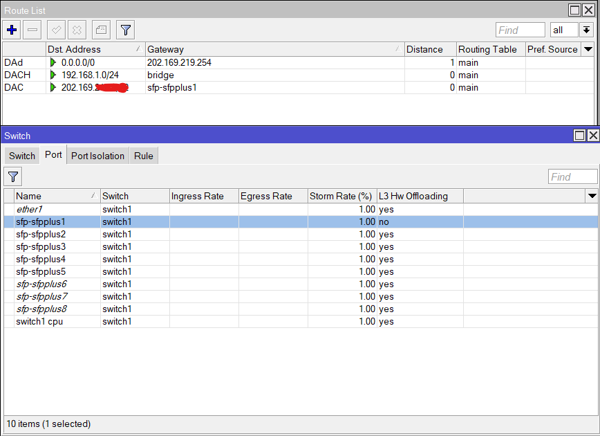

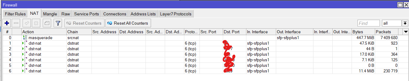

Hi, I have an issue on a CRS309 where when I enable HW Offloading on the WAN connection (sfpplus-1 in the attached screenshot), traffic will no longer route. The route shows the ‘H’ and HW Offloading is successfully enabled and shown as working on all routes, but the connection effectively stops working. I have attached some screenshots of the config in winbox (without HW Offloading enabled). I do have NAT enabled on that interface. The HW Offloading does work on the local lan with no problem.
I’m thinking there is some limitation that I’m not aware of, or I’m just missing something. Would appreicate some assistance.
Cheers

L3HW offloading only works between if all routes reside on same bridge. It seems your WAN is on off-bridge interface sfp-sfpplus1 .
This requirement applies only to VLAN. If the WAN port does not need VLAN tagging, it can stay standalone - L3HW will still work.
I guess the problem is with NAT. Please read this:
https://help.mikrotik.com/docs/display/ROS/L3+Hardware+Offloading#L3HardwareOffloading-Inter-VLANRoutingwithUpstreamPortBehindFirewall/NAT
Short answer (from what Raimond pointed to):
For NAT to work, the traffic has to hit the CPU initially, and then it pushes those NAT sessions to the ASIC. You therefore can’t enable L3HW Offload on the WAN ports or else it’ll never hit the firewall. You can only enable it on the LAN ports.
