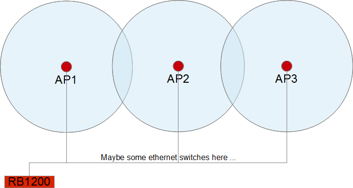

I am thinking about the same topology.
My access points will be 751g-2hnd, all of them wired to a 1200 that will be the mesh portal.
I don’t know how many switches will be between the access points but I want a roaming user to go through the whole warehouse without disconnections (2 or 3 ping packets are acceptable moving on, when it stands the connection must be stable on the better signal)
Each access point will have at least 2 SSID, one for guests (an hotspot network managed from the 1200) and one for the production network. I am wondering (not yet tried anything, I’ll try next week ,if I’ll have time) which is the best solution, where best is:

Thanks for the respose, but I am a bit confused: WDS isn’t only for wireless links? I’ll have wired links (vlan or ethernet) between access points.
I don’t need ot propagate the wireless AP to AP, they all will have only roaming clients, and this is why I looked to hwmp that if I undestood can mix ethernet and wireless links.
this will be my map… extended horizontally with other Access Points (rb751)
you say hwmp is somewhat broken or not appropriate for my needs, but what’s the benefit of wds?
thanks

I would add that in the image you posted, you don’t have a single mesh/multi-hop link. No mesh topology would be useful for you.
