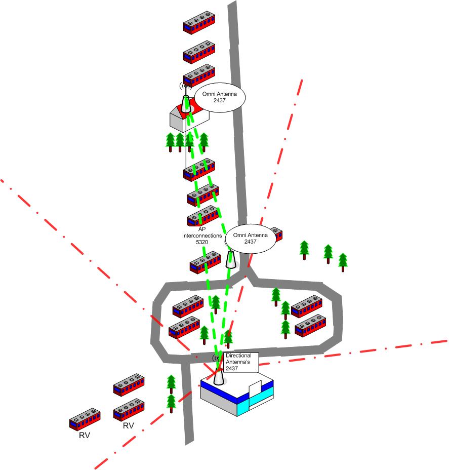

I have setup a mesh network for an RV Park. The picture below is a loose representation of how it is set up, I couldn’t find a good image to use for the OMNI AP’s so just know that all aps can hear each other, The only reason for all the AP’s is the trees and the fact that a lot of RV’s in a straight line break up the signal. Everything appears to be working, however I feel like I am losing speeds because of interference, I don’t know this for a fact, but sometimes it seems to drag and a couple minutes later it works flawlessly, I am using the simple queues that are automatically setup in a hotspot. I have 4 AP’s on ch 6 2437 and those interfaces are in the /mesh/port for mesh1. I also have the 5ghz connections in mesh/port for mesh1, however with the 5ghz, according to http://wiki.mikrotik.com/wiki/Manual:Interface/HWMPplus , are setup for wds-mode: dynamic mesh and wds-bridge: mesh1. I am wondering if I need to setup the APs for wds like the interconnections? Will that make it work better or worse? Thank you all for your suggestions and/or questions about this topic.

Well if you have a question about making it work, I will be happy to help, I found the problems was in my bandwidth mgmt on the front-end not inside the mesh.

Use different frequency at the 2.4 Ghz. APs
Sounds like you did it the same way I have. Sonny are you saying have your APs on different Frequencies?, I thought the main reason for mesh was the fact you could reuse the same frequency.
