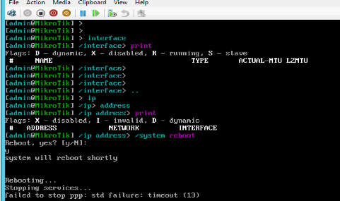

initial istall begins, restarts itself, on first start loading initrd, thengenerating ssha keys, then starting services and crashes!
after that completely turning off VM at each start

seemed to work ok. full speed. but have restarted after 2 days and it just crashed. see screenshot above.
