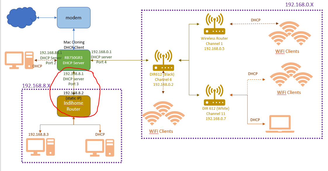

PS: added some pict on how i want to make the network. any suggestion is very much appreciated
i am able to connect to the internet if i replace the an5506-04 with my PC, is it because my PC is DHCP, while an5506 is set with static IP ?
i’ve updated my diagram which hopefully can give a better picture

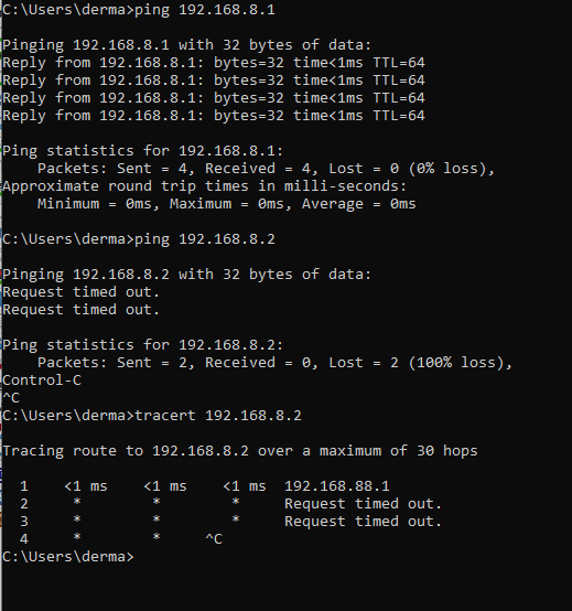

Do traceroute, see where does it stop

tracert from pc attached
