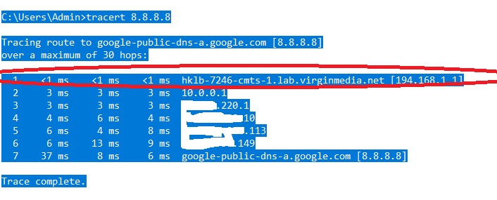

when i am tracing global dns,
it will show me “thklb-7246-cmts-1.lab.virginmedia.net [XX.16.1.1]” one dns in my device in hoop list. kindly find the screen shot.
Are you located in the UK and subscribing to Virgin Media cable service?
If not, you are probably the victim of a bad sysadmin who used 194.168 instead of 192.168 for the local
network, and you are together with a lot of other users behind the same NAT towards internet.
(difficult to see because you blotted out the addresses - don’t do that! it does not reveal anything that could harm you)
Anyway, you will have to live with this “problem”. It is just an artifact of the way you access internet and the
way that Google handles abuse. As long as you access internet via the same address that others use to do abuse,
you will have this.
If you configured local LAN as 194.168.1.0/24 instead of 192.168.1.0/24 then DNS name of your gateway is resolved to external name.
You didn’t show your configuration so it is just a guess.
I have changed Local end Ip address with 192.168.10.1/24 and and monitored , i get again same issue .
Define “same issue” => You still get 194.168.1.1 as first hop in your traceroute? Then post config without masking internal addresses.
If you still have issues with Google, as pe1chl mentioned, you probably have to find a way to stop over-requesting Google servers. Either by reviewing your router configuration and checking clients for malware. E.g. check the firewall connection table for noticeable (amounts of) connections.
Do you get a public IP from your ISP? Use something like iptracker on that IP to check if it really belongs to your internet provider. My guess is that your ISP is doing some messed up NAT and that might cause this issue.
Just to be clear, most sites will think that you are a robot if there are too many connections coming from the same IP. This is why me and others here are insisting on a NAT or an wrong internal IP address configured either on your side or in your ISP side.
Which internet provider do you have?
It is not your router but your provider. If there are too many Google requests from the same network (read your network providers) this robot message appears to check that it is not a robot that overloads the network.
