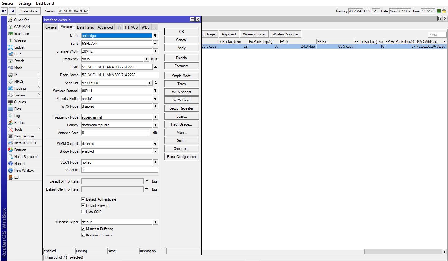

hello good night, I have a problem I have an omnitik which I connect my clients with crazy nanostation m5 works well what happens to me is that I can not access the nanostatio m5 connected to the omnitik from my location, how can I make it transparent that I can access the nano equipment that connect to the omnitik
[/img]

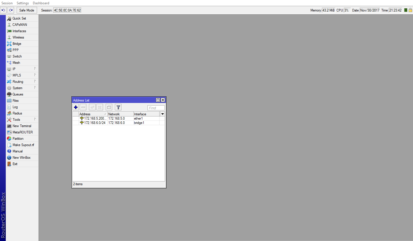

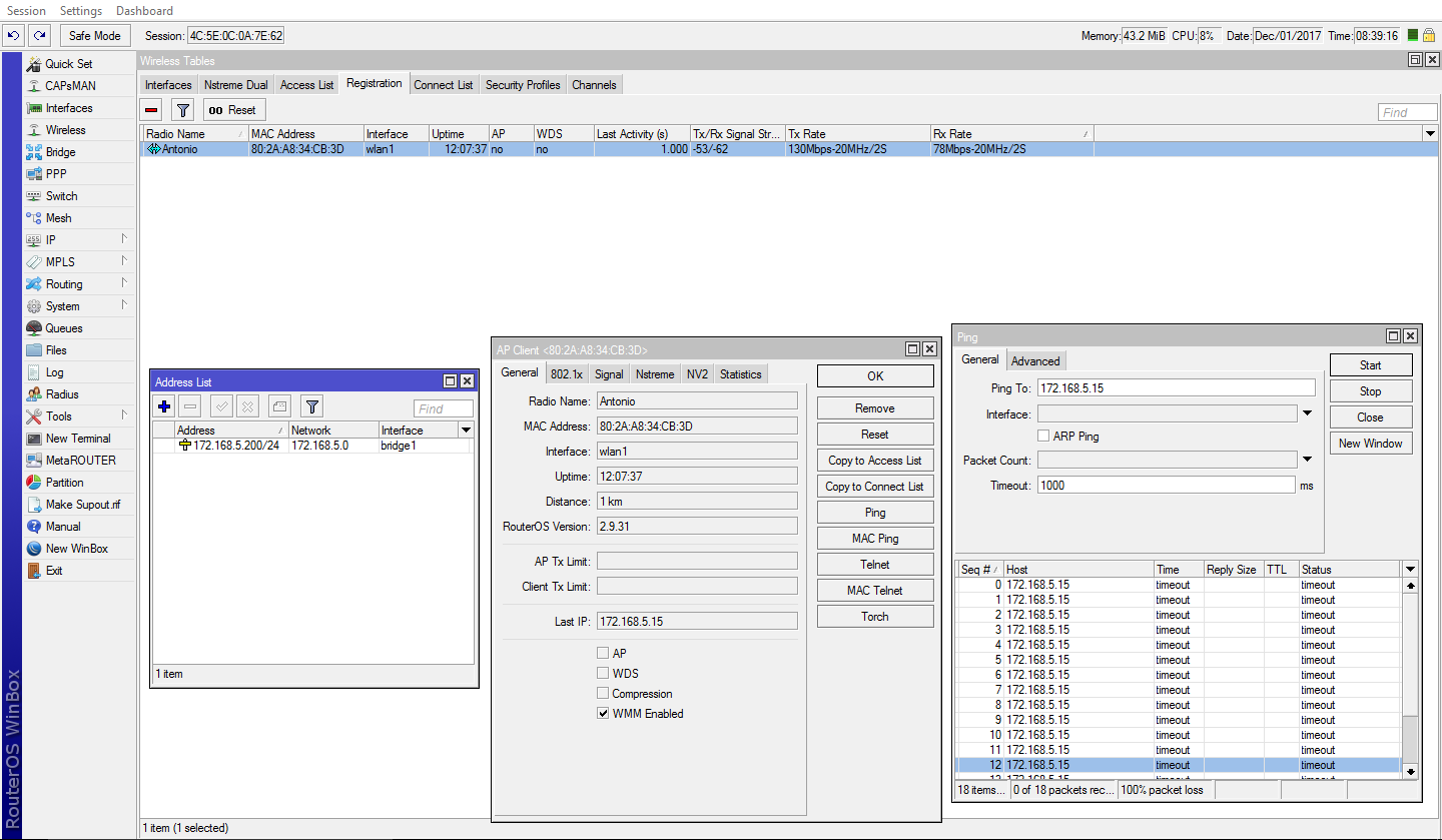

Move IP .5.200 from ether1 to bridge1.
I understand there’s nothing on Ip > Firewall > Nat
thanks for the answer, I made the change of .5.200 to the bridge, I ping the nano ip, I do not receive an answer, if I ping any other computer in the network, if it does, what configuration I need, I need help, please

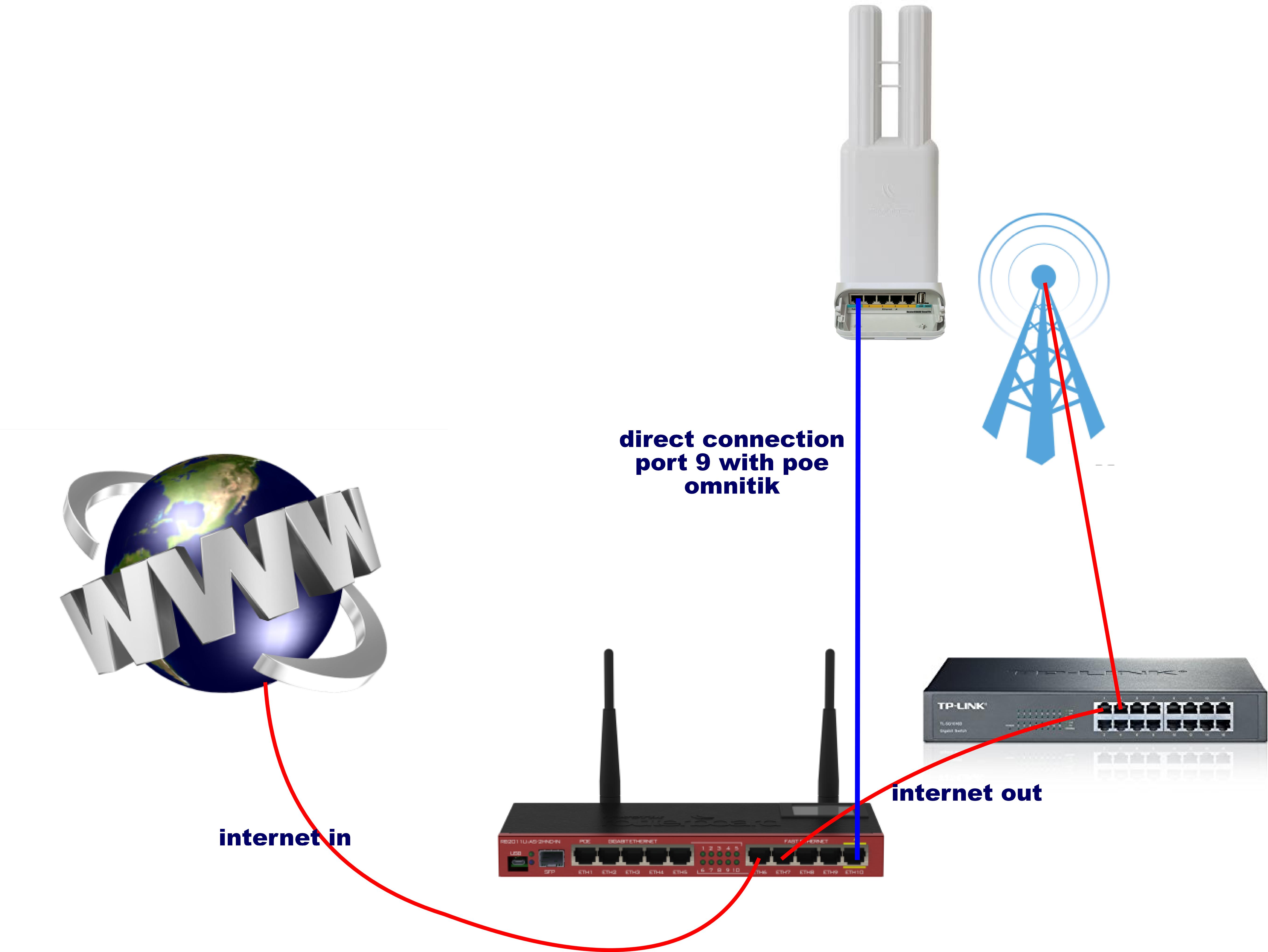

diagram of my network in case it helps

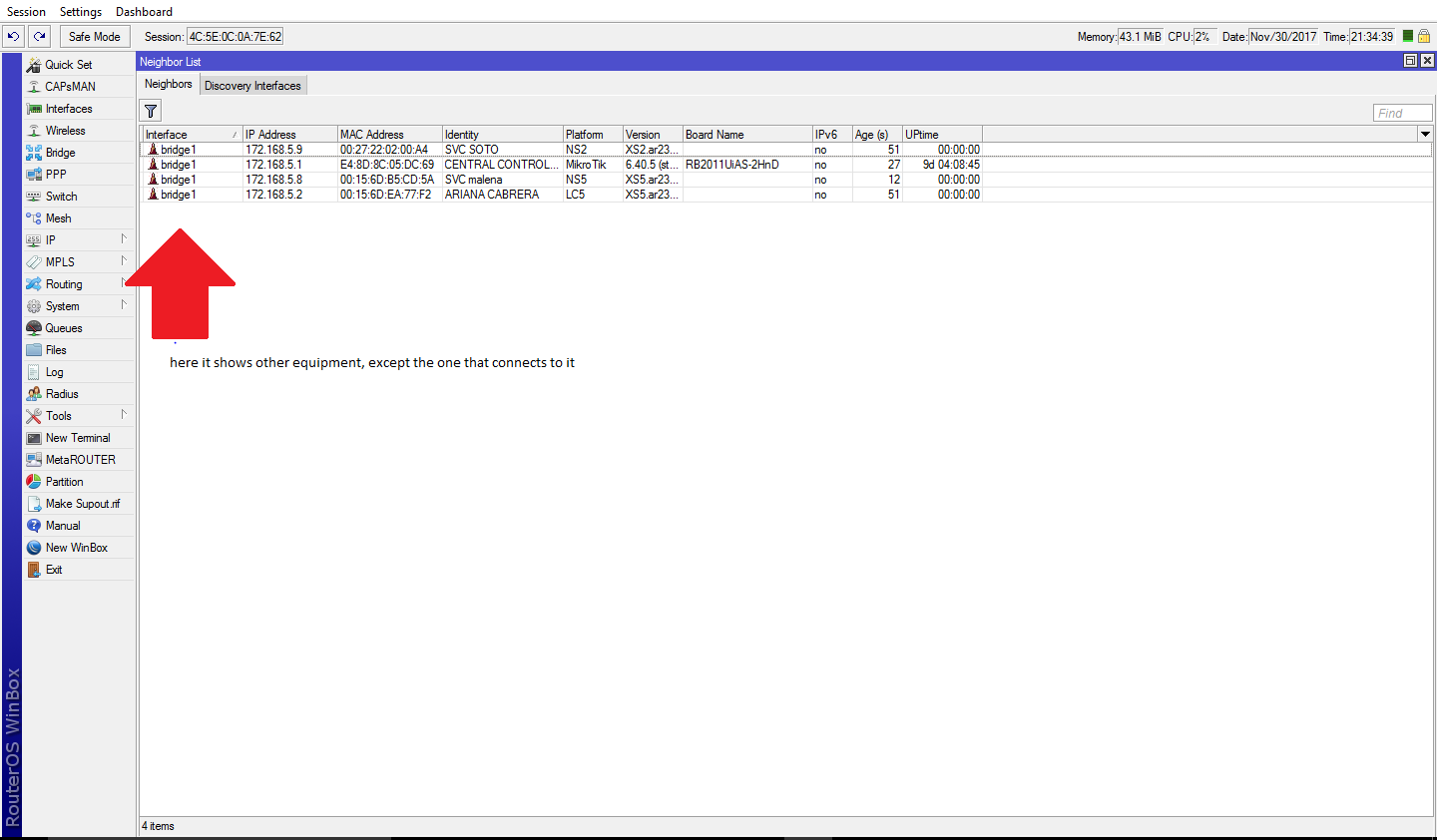

Are you sure the nano hasn’t resetted itself to 192.168.1.20? Can you see it via IP > Neighbors?

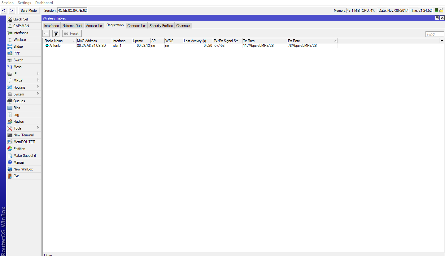

I can not see it it via IP > Neighbors?but the client has an Internet connection perfectly and, as you can see in it, the connection appears and the nano station .
