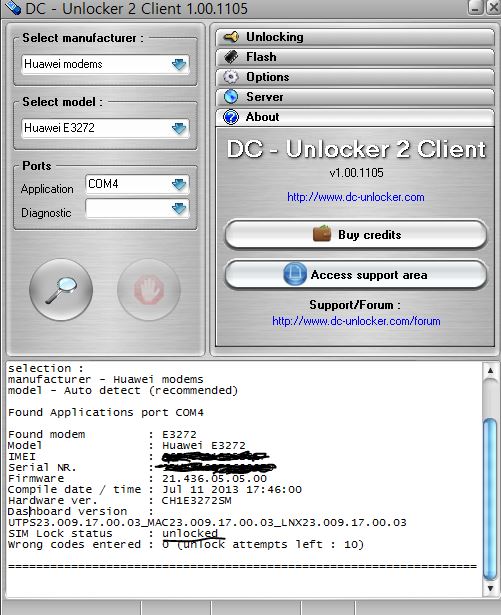

I have a Huawei E3272.
I can not see LTE interface at ROS 6.10.

What kind of router hardware do you use?
Is the device visible under “/system resource usb print”?
I use the E3272 on a CCR which is running 6.10. The LTE interface appears shortly after I plug it in.
It is RB751G-2HnD
Most important:
here…
There are multiple versions of this modem. Looks like only modem with device-id=“0x14db” works as LTE interface.
You can try to use the ppp-client with your modem.
I hope to support LTE interface at multiple version of this modem.
