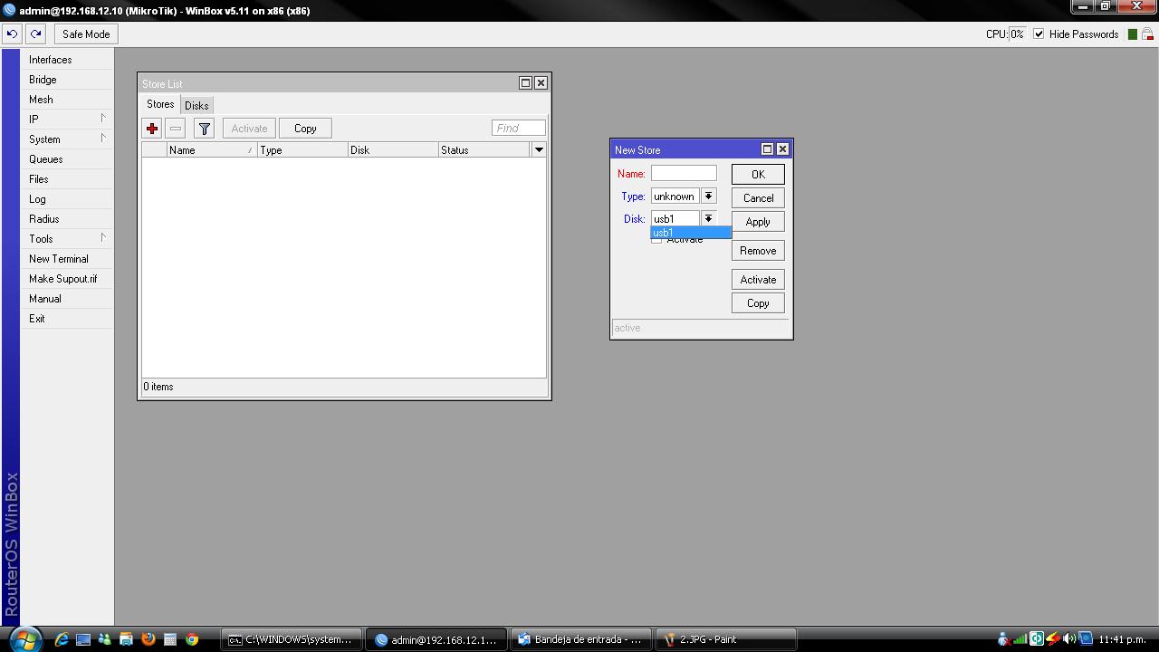

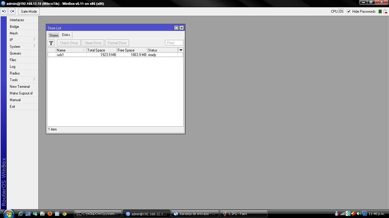

I installed the system on a Flash Memory (USB) and the place my DELL R610, boot and OS system: rip well but does not detect the disks but if you see the Dell SAS controller.
If I do the same with the HD system will not boot, stays in LOADING.
Attachment system images installed on USB flash memory in the Dell R610.
Other pics.
It seems like that ROS has no driver for your SAS controller. Maybe you can put in an additional SATA controller.
