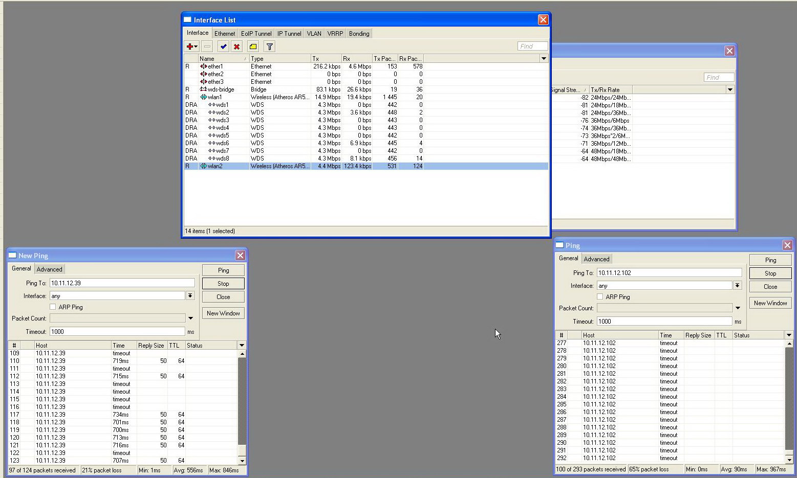

Sometimes there is a very strange problem. Here is a screen…
what is due this?
in routeros ping over 1000ms is considered timeouted.
But why is this problem ?
80% it`s work perfect, sometimes when the traffic goes up, it start to make this prolem…
And take a look, all station wds have same amount of traffic… strange!
I have the same problem.
Has anyone already found a solution to it? All this strange traffic is generated by the protocol 34916 (pppoe-session). Even if one does not connect to pppoe through this interface, the traffic is constantly generates.
