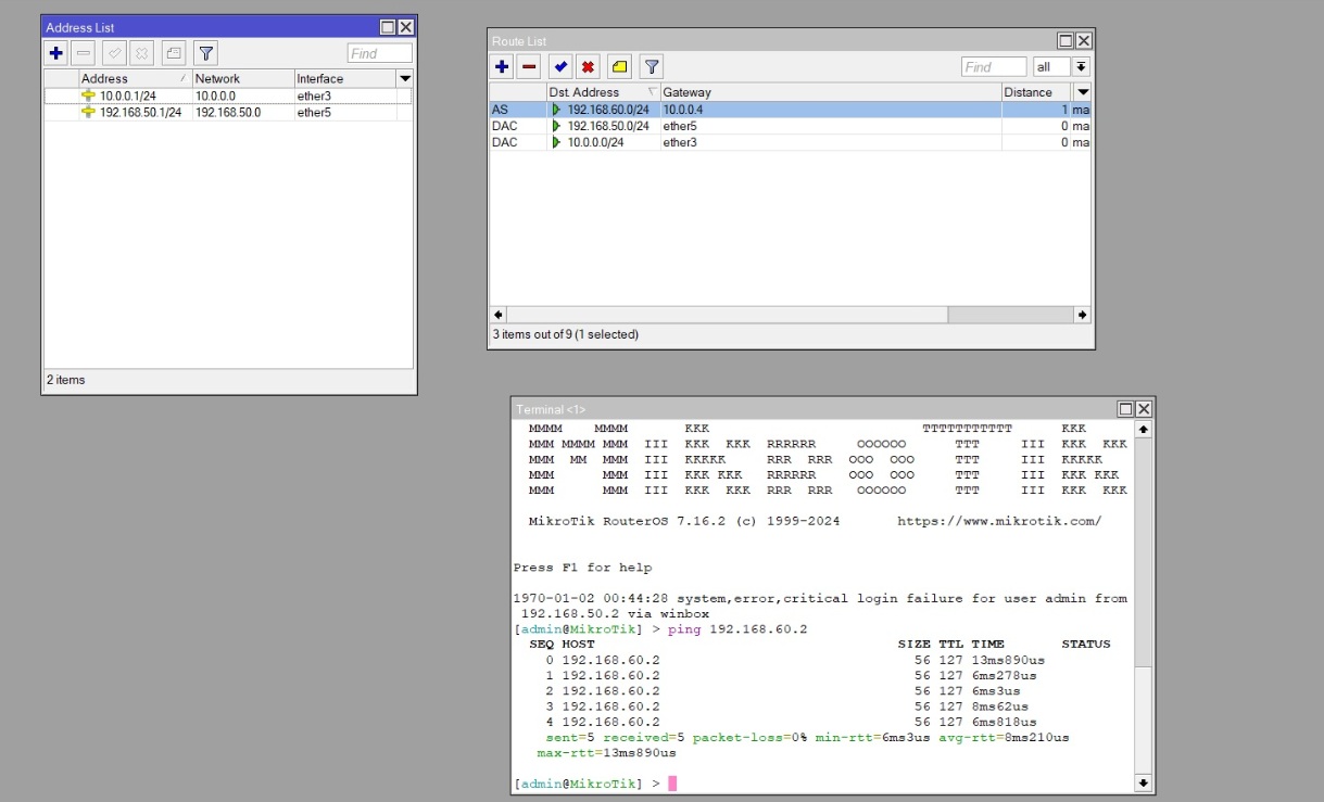

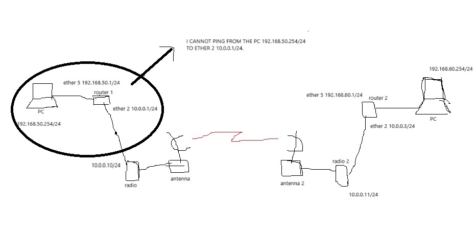

I am doing static routing with mikrotik through a radio link. I cannot PING between ether 5 interfaces (where I have a LAN connected, with network 192.168.60.0) and ether 3 (where the link is, with network 10.0.0.0) on a mikrotik. THIS MAKES ME UNABLE TO PING BETWEEN THE TWO POINTS FROM A PC WITH IPS 192.168.50.254 to 192.168.60.254
I can ping from the mikrotik terminal, but not from a PC.
I attach an image of my network diagram and also of the static routing programming.

First problem I see is that you are showing 10.0.0.4 as the gateway, but there is no 10.0.0.4 device on your network drawing.
Sorry, in the schematic I put 10.0.0.3 it is 0.4. That is the network of the link 10.0.0.0. The static route appears, but I cannot ping between the network 192.168.50.0/24 and the network 10.0.0.0/24.
