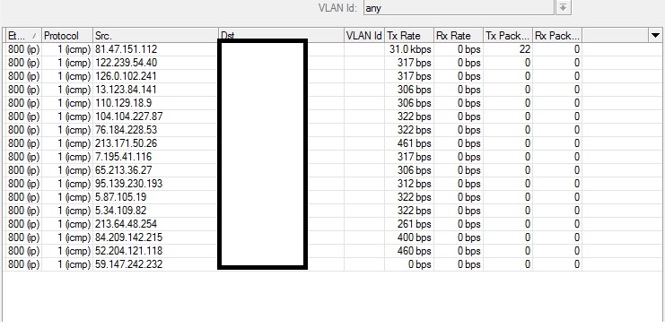

I am not enable to block this traffic to my router, im using this rule,
chain=input action=drop protocol=icmp dst-address=x.x.x.x icmp-options=0:0-255
What am iam doing wrong? ?
Regard..

doesn’t help, I still cant catch the traffic ![]()
If I try ping from a website to my public address it works, so what is the traffic iam getting? ?
wrong by me, the traffic goes out of the router, I can catch the traffic if i am using the output chain.
But I cant find where the traffic is generated?? I dont see it on my Lan interface
it looks like the router is generating this traffic :S
Solved, It was an dns attack
