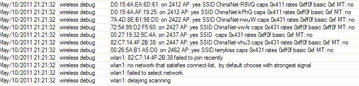

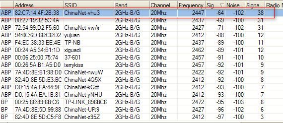

I can't connect to my wireless by routeros
i use routeros to make it to be a station to connect to my neighbor’s wireless network, but it display"failed to select network". but the ros can connect other router wireless. i can connet the network by windows xp or windows7 system. please help me? thanks(i have tried 4.17 and 5.2 version)
attach more configration picture, help me. thanks very much

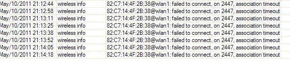

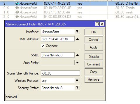

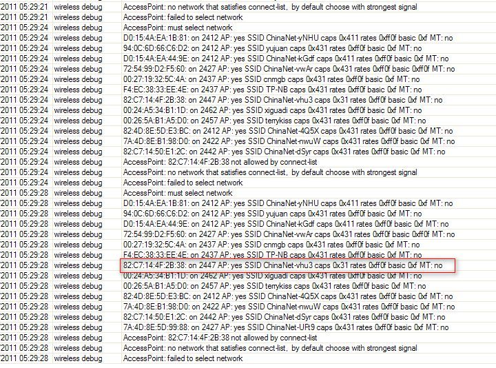

Your log shows that you are not allowed to connect to the specific mac address outlined in red due to an entry in the connect-list.
Please post “/interface wireless connect-list print”.
[admin@MikroTik] /interface wireless connect-list> pri
Flags: X - disabled
0 X interface=AccessPoint connect=yes mac-address=00:19:E0:AF:DC:4E ssid=“Tenda” signal-range=
security-profile=Tenda wireless-protocol=any
1 X interface=AccessPoint connect=yes mac-address=00:27:19:32:5C:4A ssid=“TP-LINK_325C4A” sign
area-prefix=“” security-profile=week wireless-protocol=any
2 X interface=AccessPoint connect=yes mac-address=94:0C:6D:66:C6:D2 ssid=“yujuan” signal-range
security-profile=yujuan(hide) wireless-protocol=any
3 interface=AccessPoint connect=yes mac-address=82:C7:14:4F:2B:38 ssid=“ChinaNet-vhu3” signa
area-prefix=“” security-profile=ChinaNet-vhu3 wireless-protocol=any

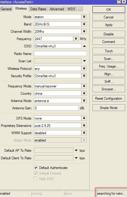

i post my wlan card configration
[admin@MikroTik] /interface wireless> pri
0 ;;; Inside
name=“AccessPoint” mtu=1480 mac-address=00:0A:EB:A2:3F:89 arp=enabled
interface-type=Atheros AR5212 mode=station ssid=“ChinaNet-vhu3” frequency=2447
band=2ghz-b/g channel-width=20mhz scan-list=default wireless-protocol=any
antenna-mode=ant-a wds-mode=dynamic wds-default-bridge=none wds-ignore-ssid=no
bridge-mode=enabled default-authentication=yes default-forwarding=yes
default-ap-tx-limit=0 default-client-tx-limit=0 hide-ssid=no
security-profile=ChinaNet-vhu3 compression=no
help me! thanks very much
Try disabling rule 3 in your connect-list. You still have “default-authentication=yes” on that interface, so it should connect without an entry in the connect-list.
ADD: Is this a wds bridge connection? The station has wds-mode=dynamic. Is the AP set for wds?

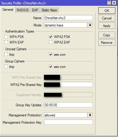

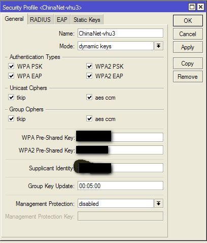

I see you posted the security profile above. It appears you have too much selected. Only one type of security should be selected. Check your ap and see what it uses. It should use only one type of security. Then match that in this station.
i have Tried disabling rule 3 in my connect-list, but it’s also not working. my network card is not wds bridge connection, i have changed wds-mode=disable, it’s not a AP, just a station to connect to my neighbore’s wireless. i changed my profile to just one type.
  1. i disable connect-list, it’s not working
  2. i disable default-authentication=yes, but enable connect-list rule 3, it’s also not working

[admin@MikroTik] /interface wireless security-profiles> pri
0 name=“ChinaNet-vhu3” mode=dynamic-keys authentication-types=wpa2-psk
unicast-ciphers=aes-ccm group-ciphers=aes-ccm
wpa-pre-shared-key=“" wpa2-pre-shared-key="
supplicant-identity=“******” tls-mode=no-certificates
tls-certificate=none static-algo-0=none static-key-0=“” static-algo-1=none
static-key-1=“” static-algo-2=none static-key-2=“” static-algo-3=none
static-key-3=“” static-transmit-key=key-0 static-sta-private-algo=none
static-sta-private-key=“” radius-mac-authentication=no
radius-mac-accounting=no radius-eap-accounting=no interim-update=0s
radius-mac-format=XX:XX:XX:XX:XX:XX radius-mac-mode=as-username
radius-mac-caching=disabled group-key-update=5m
management-protection=allowed management-protection-key=“”

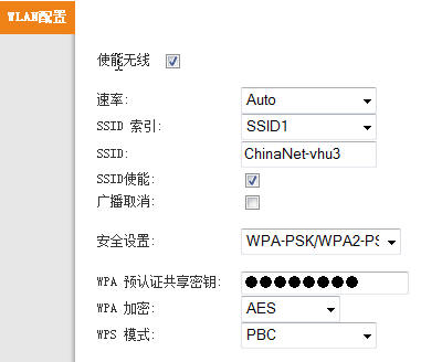

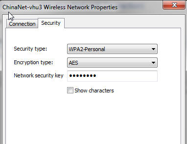

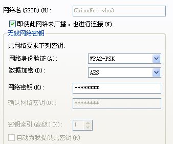

Does the neighbor’s wifi ap have wpa2-psk set as the security setting? Same wpa2 key? If the key doesn’t match, no connection.
of course, my neighbour’s wifi is wpa2-psk with AES encryption type. i am using now. i sure the key is right

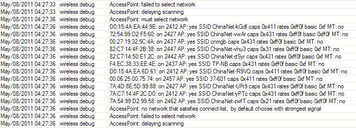

The only thing I see that is different is the “caps 0x31” value for that AP in your log. Mine show “caps 0x421”. The rest of yours show “caps 0x431”. I have requested that info from support, but it may be a couple days since it is the weekend.
Anyone else know what that means, and how to decode that hex number?
Otherwise, I am out of ideas.
