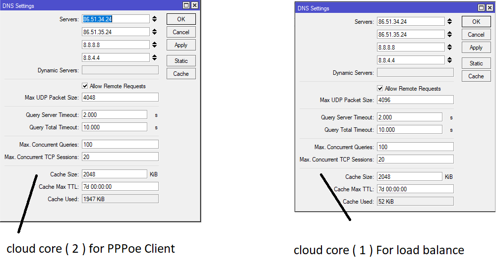

Which DNS server do you use on routers in order to resolve DNS records?
look at the pc

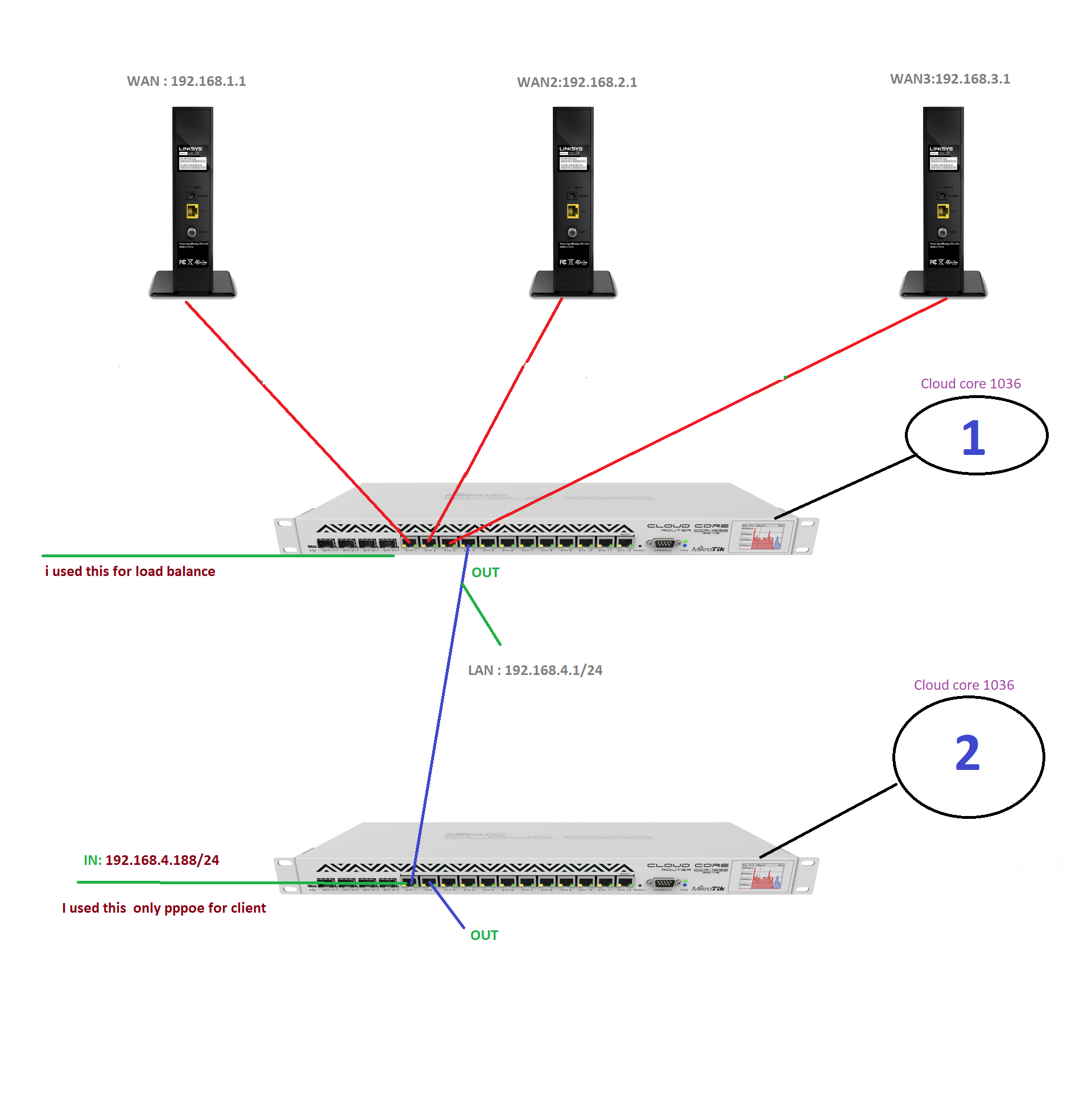

In first picture we see that IP address is 192.168.4.1/24
But in cloud we see 178.80.xxx.xxx
I didn’t remember which IP address cloud are getting..
Please provide full IP structure.
As I understood you need forward winbox management port on first router and accept management firewall rule on second router.
P.s. DDNS - it means it taking external IP address, so it is CCR1 , remove DDNS and you get CCR2 WAN IP address
this is my guess , try remove DDNS and check which IP address you’l get ?

you are double NAT’ed, so if you want connet from WAN to CCR2, then you must add forwardin rule in CCR1

cloud core ( 1 ) Site A
Cloud core ( 2 ) Site B
i’m trying connect from Site B
