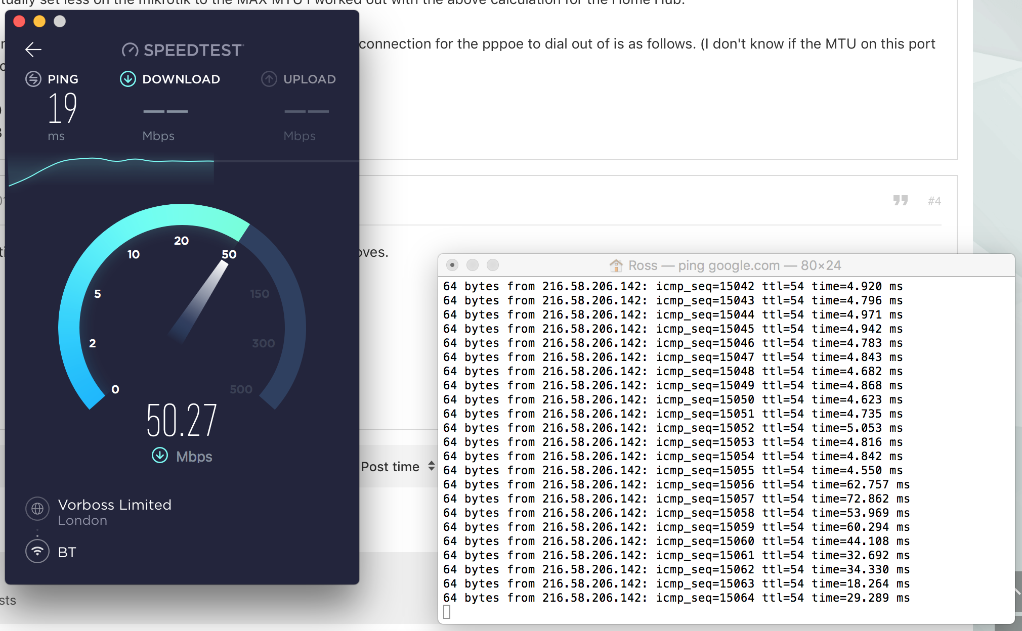

Before the test starts -

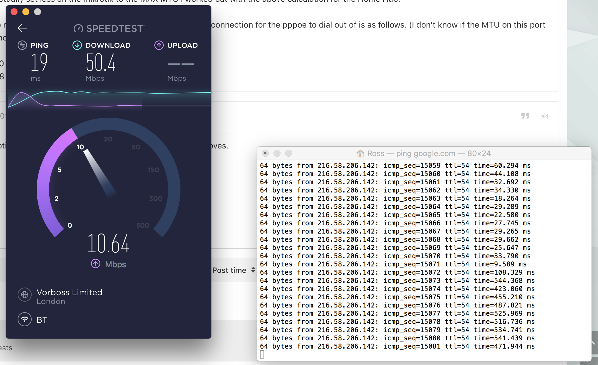

During a download -

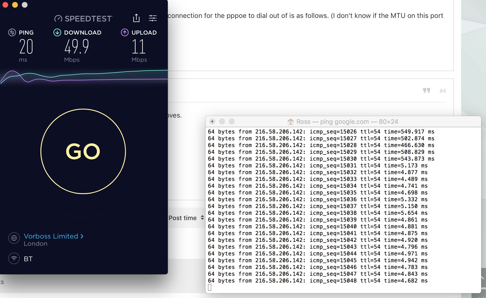

During an upload -
