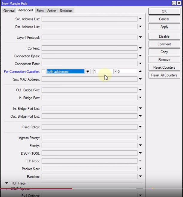

I have 8 ISP modems and I want to load balancing with the 8 modems how to set the pcc in mangle rules
I have 8 ISP modems and I want to load balancing with the 8 modems.
How should I set this mangle rule per connection classifier?
Both addresses: 8/0
Both addresses: 8/1
Both addresses: 8/2
Both addresses: 8/3
Both addresses: 8/4
And so on? or do I have to set it differently?
Thank you for your advice

the mangling depends on the spread of load: are all same throughput? then you can proceed as suggested.
I don’t understand this.
Can you give me more explenation please?
For 8 ISP’s for load balancing how i to do that can you give me a example.
And so on?
Yes, or you can use just route with 8 gateways.
Suppose you have 2 (less work for me) connections A & B:
  1. A = B = some speed, then just mangle as documented
    A: 2/0 & B: 2/1
    2 A = 2B = some speed, then you want to assign 2x more to A than B, so
    A: 3/0
    A: 3/1
    B: 3/2
Right?
